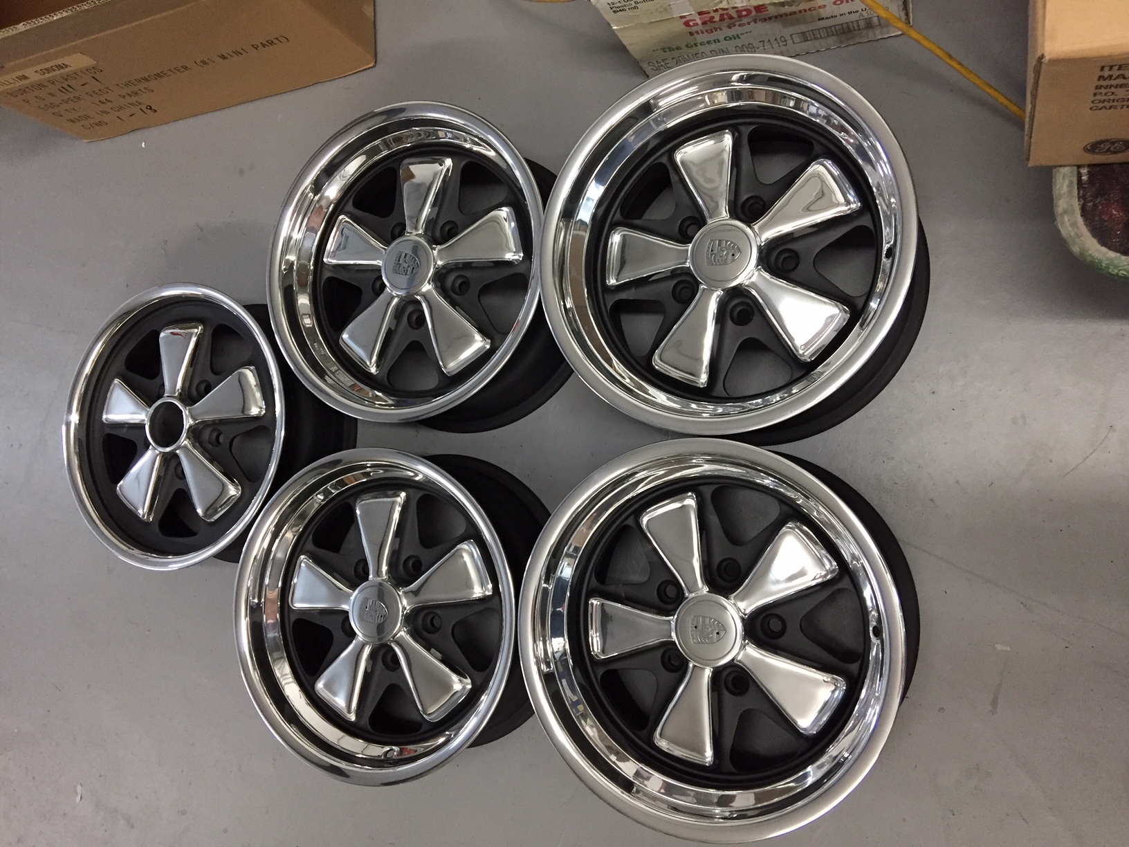

Today I picked up my wheels 15” 7s, 8s, and one 6” spare for space saver from Rick at http://www.porschewheelservices.com/ To go on number 41. We are getting closer. I have a bunch of progress work pictures to up-load from Eric
