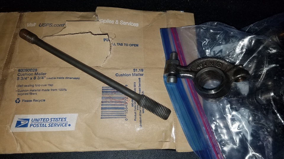

Dominic was nice enough to send me a straight engine stud and I got my 1.7 rockers with 911 adjusters.
