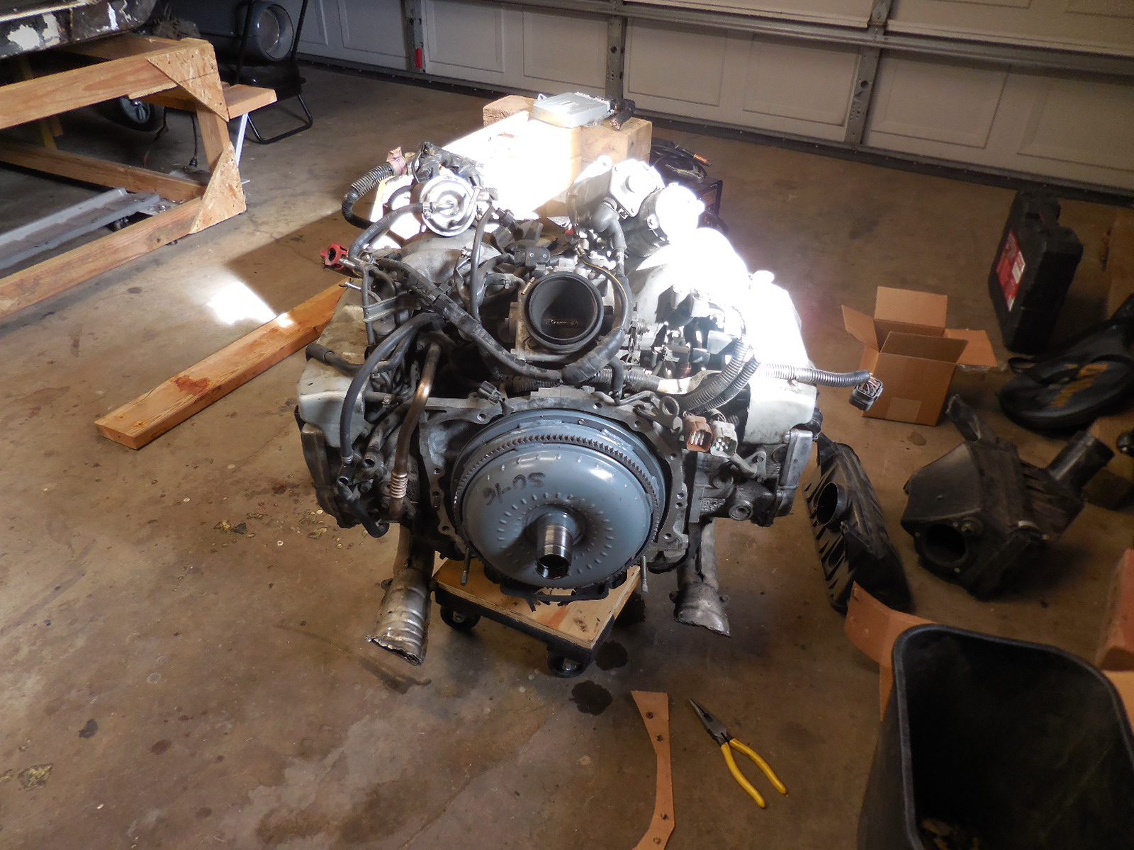

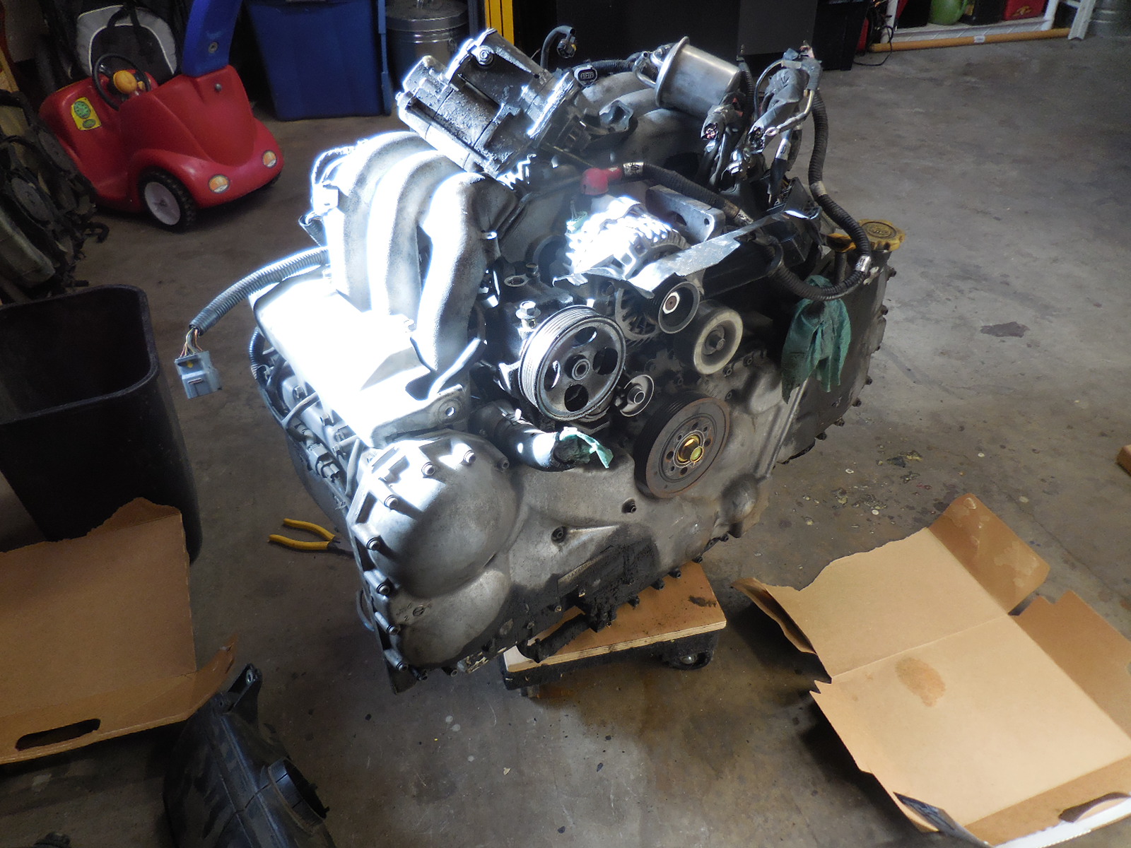

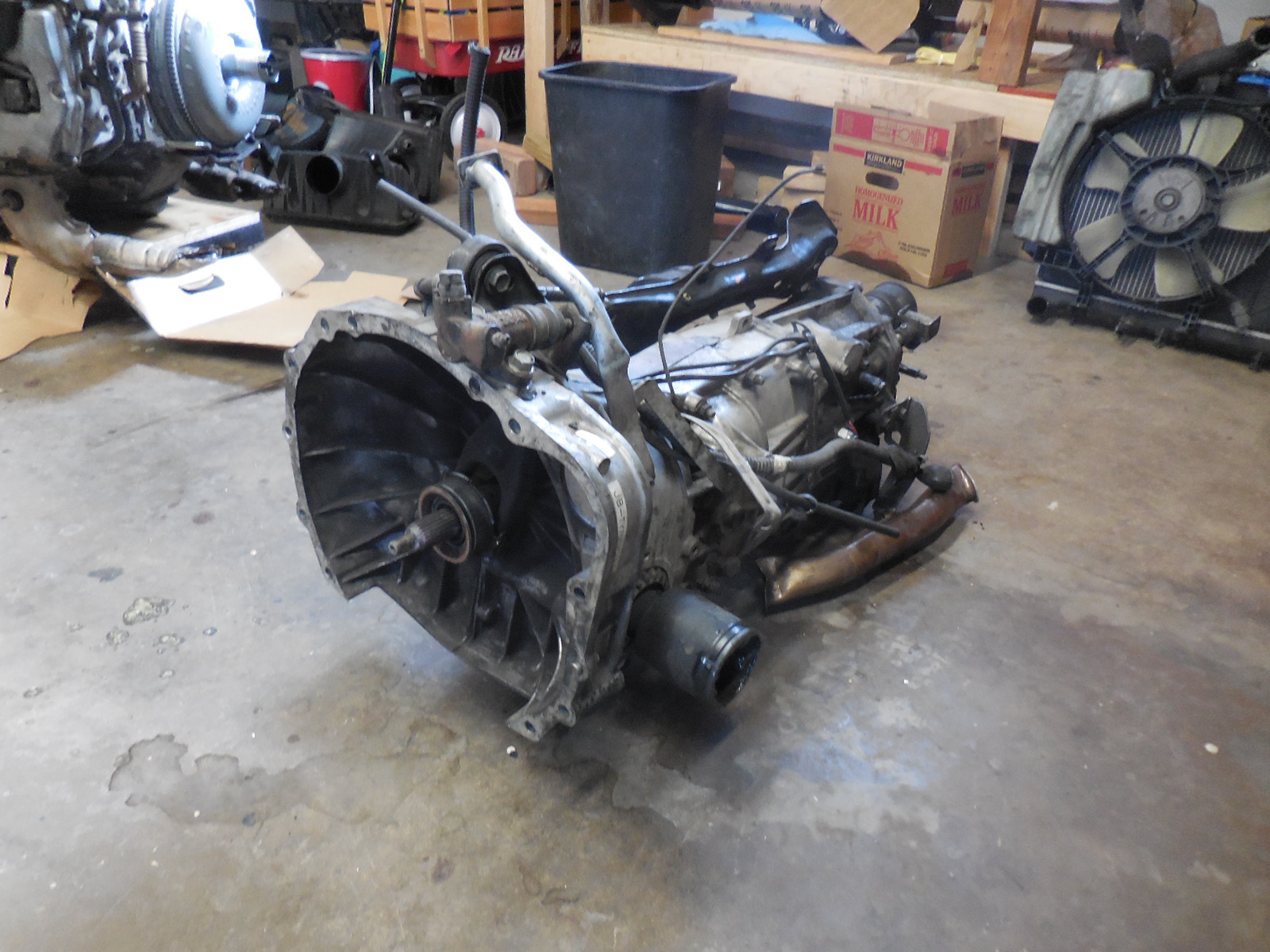

I recently purchased an EZ30D engine and transmission and have a few questions regarding next steps. I pulled the motor from a LL bean subaru at the junkyard so dont have the mileage. The transmission is from a 5 speed forester.
My questions are as follows:
Mount
- I am having trouble finding a mount/cradle from coldwater or anywhere online. Is it a bad idea to fabricate my own given the increased hp?
- Are there other alternatives for mounting
Engine
- Is the best approach to just rebuild the engine before putting it in?
- Is cost to rebuild about $300? Saw seal kits and bearings for this but not sure if there is anything else i need
- Can I do some testing on the engine to make sure it's good?
- Check compression on each cylinders?
- Check valve lash?
- Use a camera to look inside cylinders?
Electrical
- Are there any other accessory type items we need from the Subaru?
- Anything from the dash
- PCM stuff?

rnellums   Brett, don't rebuild the motor, is cheaper and...   Jan 28 2018, 09:14 PM

rnellums   Stick with the hydraulic clutch. After looking bac...   Jan 28 2018, 09:18 PM
