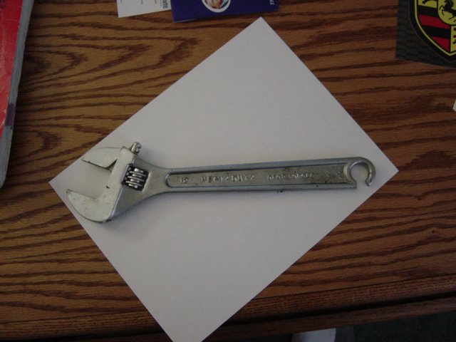

Whats the trick to replacing the rollers for the rear trunk?

Take a 12" cresent wrench. Cut a notch in the loop on the back end until you have a C shaped opening instead of the loop. Hook it over the torsion bar, and pry down the torsion bar until you can change the roller.
Thats what I did and it worked very well!

ClayPerrine   Take a 12" cresent wrench. Cut a notch in the loo...   Nov 8 2004, 03:45 PM
