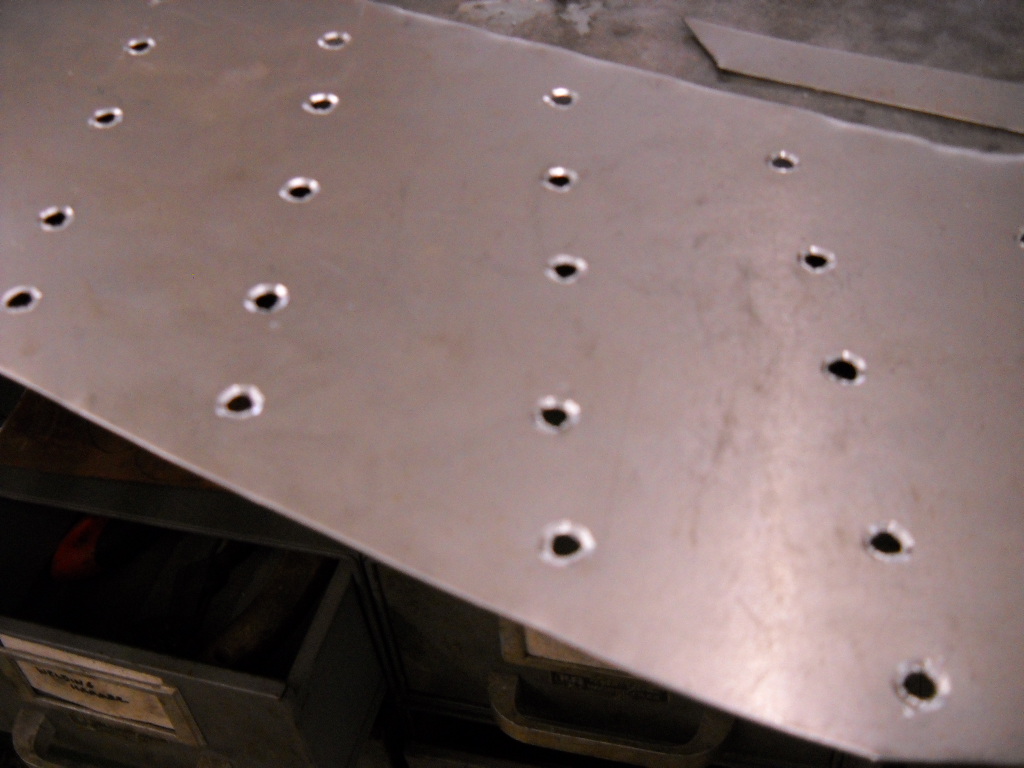

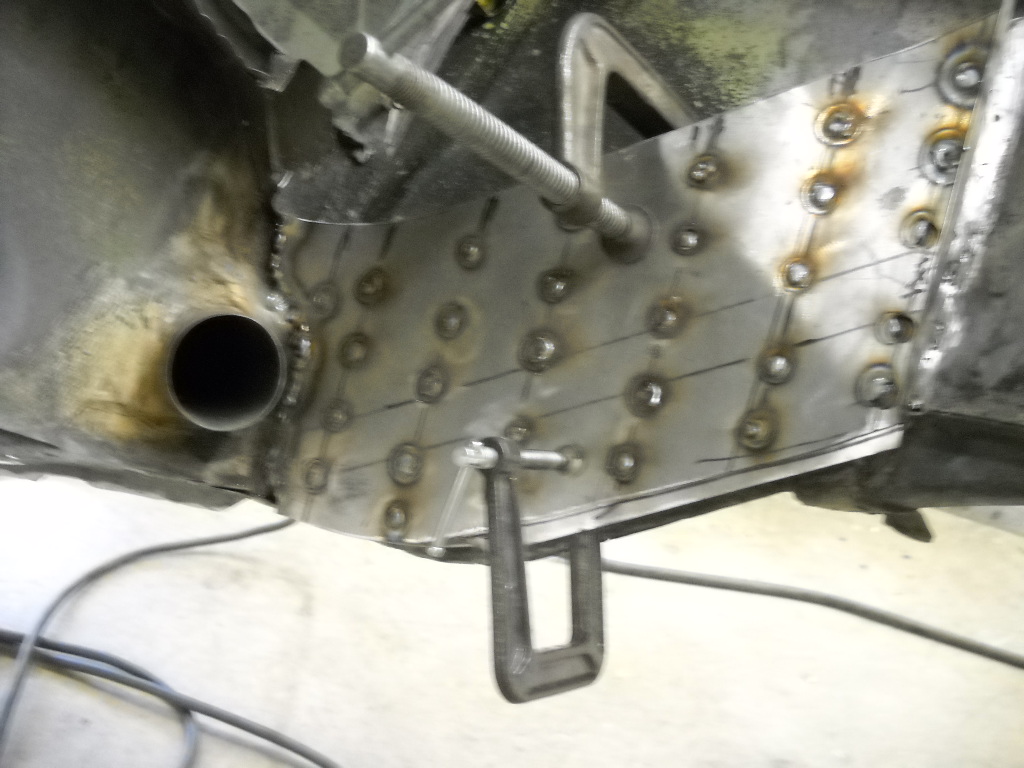

After grinding off all of the layers of crappy reinforcements that were stacked on rust, partial welds etc, time to make some pretty repair panels;

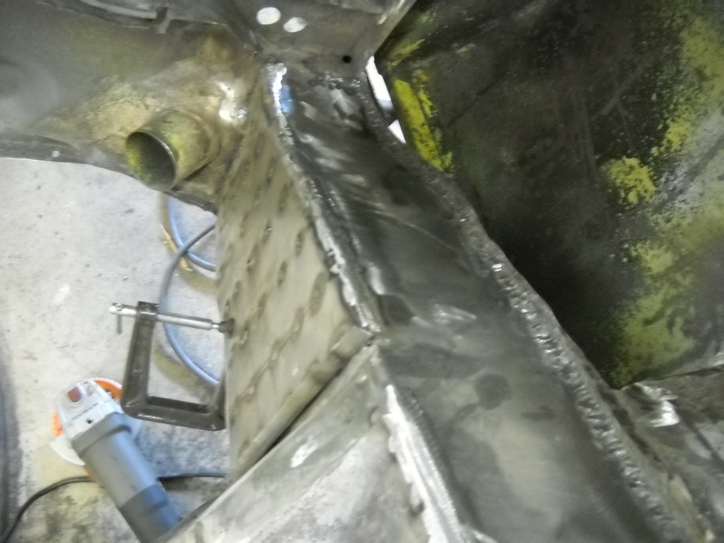

Now lay the panel on , start plug welding in the middle and work out.
Now reinforce the top of the rear suspension above the console.

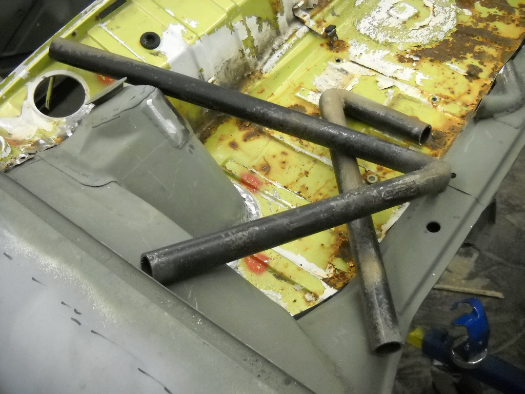

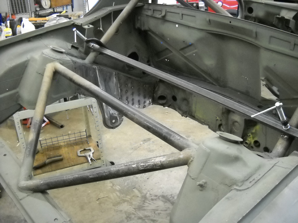

The previous owner had cut out the rear trunk floor along with the rear suspension console cross member. The arched sheetmetal box section at the rear of the engine compartment opening, and replaced it with 1.5" x .120 wall tubes that were paerially welded in place. This triangle had been 'bugging' me since I bought the car.
I had guessed the triangle was heavier that the origional structure and since tthe triangle was only partially wellded ( they welded where it was easy to access- total lack of planning on the part of the welder)

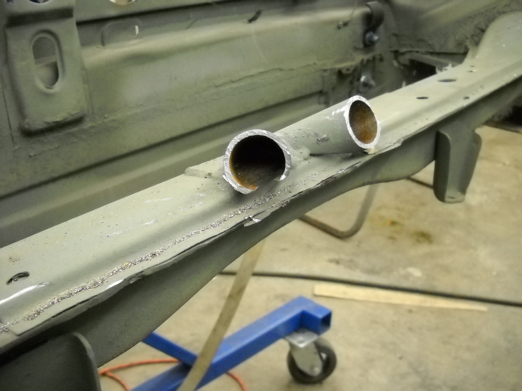

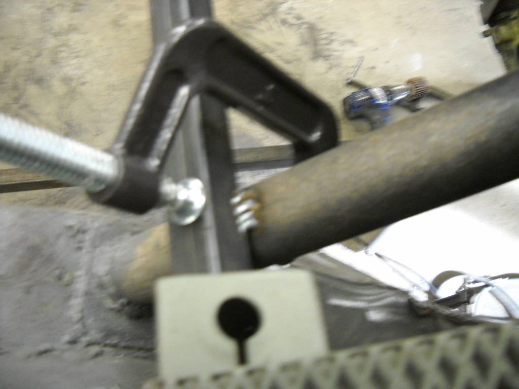

You can see the square tube I welded in to the rear diagonals of the roll cage. Just in case things want to tweak.
So finally get to see how much the weight difference is....
Stock floor is the lighter in weight. and no doubt stronger, look at the lack of weld on the diagonals;
Next reattach the floor and the cross brace. I'll be making my own rear floor section.
