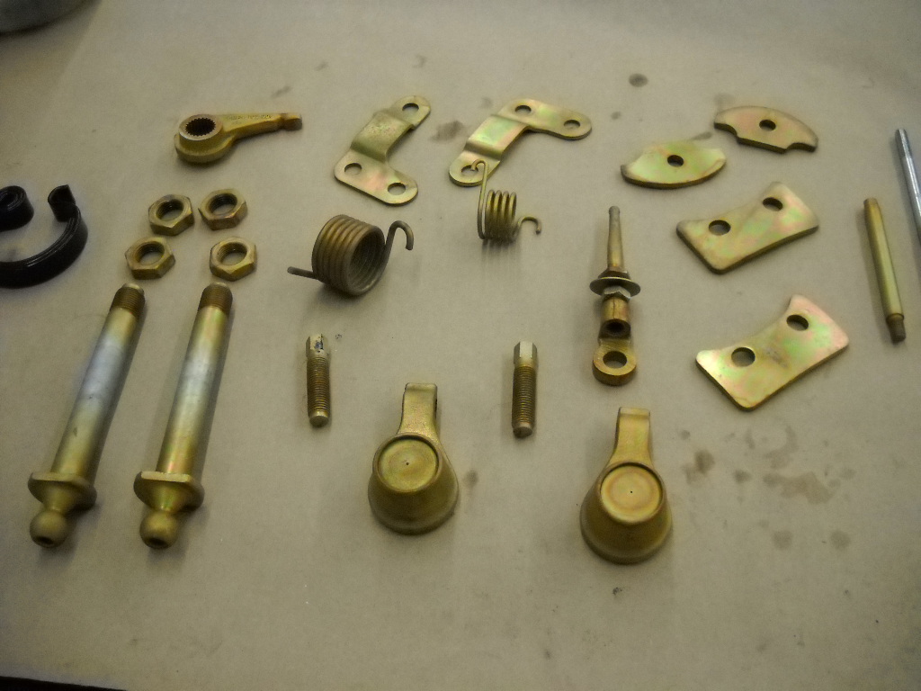

I strained my back, so grinding/welding is uncomfortable, time to do some busy work. Clean small parts and start plating them.
I got some of the Zinc Chromate pretty parts nicely plated.
I'm doing some other parts with just shiny zinc; suspension shims, etc.
Cleaning and prep take the most time. I plate a few parts at a time, set a timer to remind me to take the plated parts out of the 'bath' and put in a few more while I'm working on something else.
Pretty amazing what you can do with vinegar/Epsom salts, a piece of zinc and a D cell battery. After you get the zinc on, dip the part in the yellow zinc chromate bath, and hang to dry.
