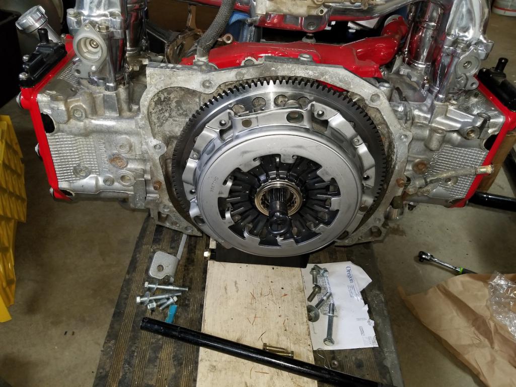

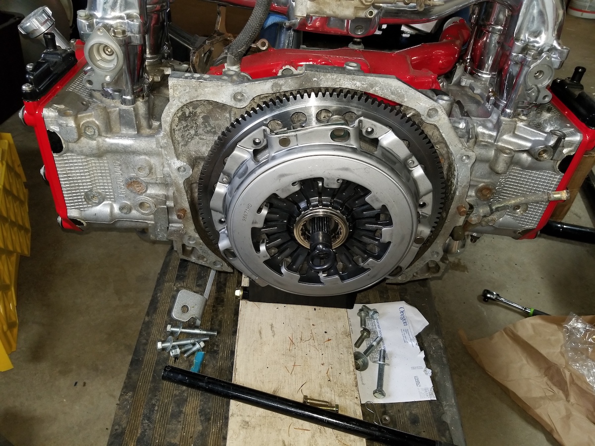

Well after a whole lot of looking & organizing. My garage still looks like crap. I did manage to find 1 of my conversion plates for the MC. I had moved onto my motor. Removed me tranny. Just had it bolted up for test fitting. Still needed to install my Flywheel, clutch & pressure plate. So installed the flywheel & torqued the bolts to 52lbs. Installed the flywheel bearing. Went to install the clutch & pressure plate but I could not find bolts. Looked at the local parts stores with no luck. Ordered some from Subaru dealership. Supposed to be here Wednesday. Going to bolt it to my engine stand. I've got a small car mount on it I am not using. The side with the dipstick tube on it I've got to pull the oil pan to remove. Not a big deal I'll try to tackle it tonight. Taking a break for some dinner. Then need to get pick up some stuff to make Mike Moorman's rotella dip for the big game tomorrow. Good to finally do something on my car. Didn't amount to a whole lot but it is progress (IMG:style_emoticons/default/blink.gif)
