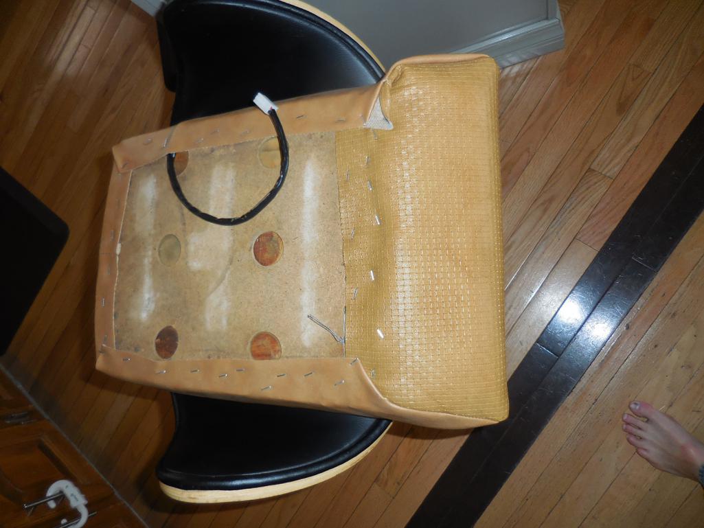

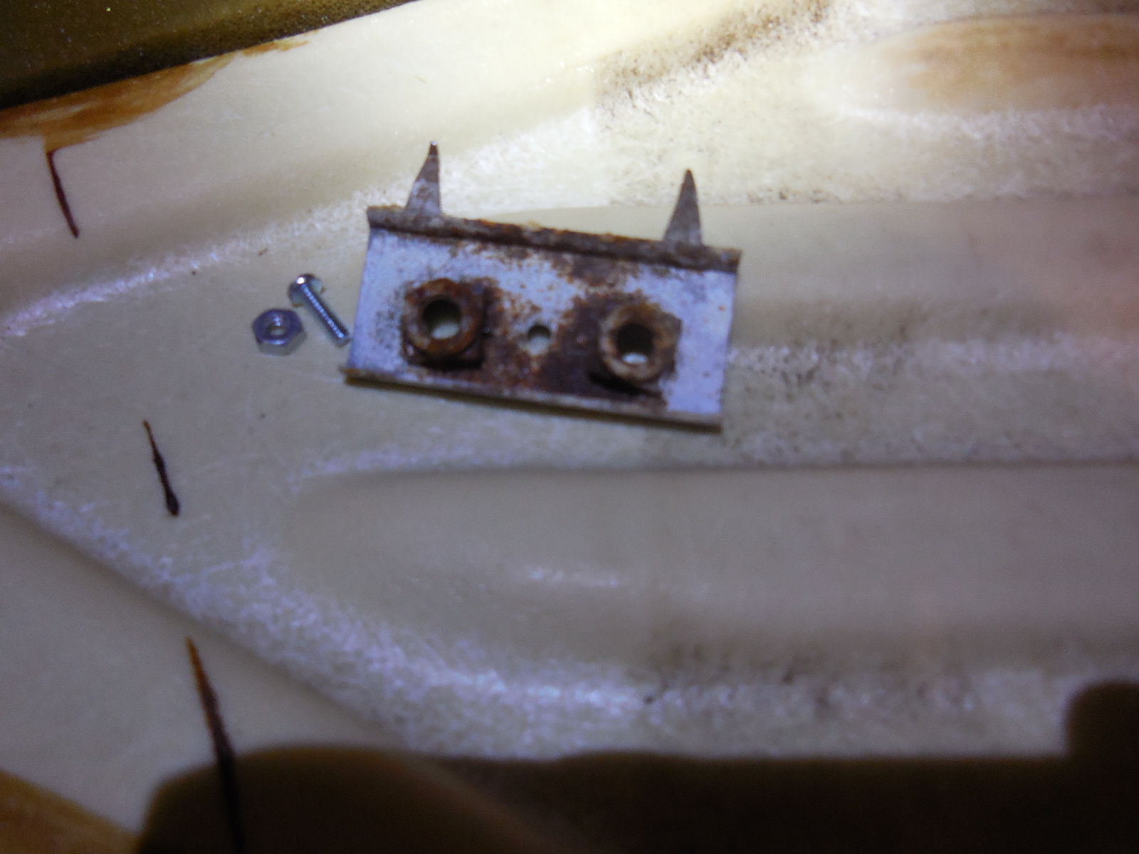

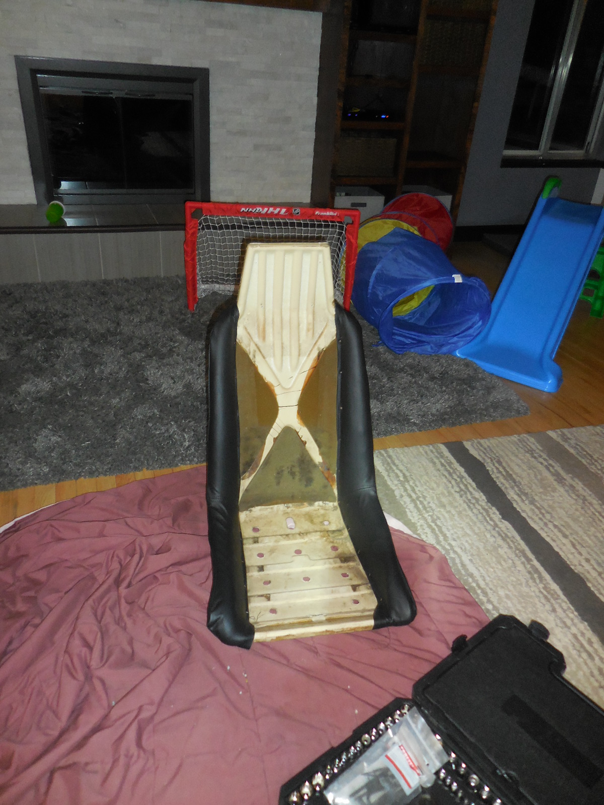

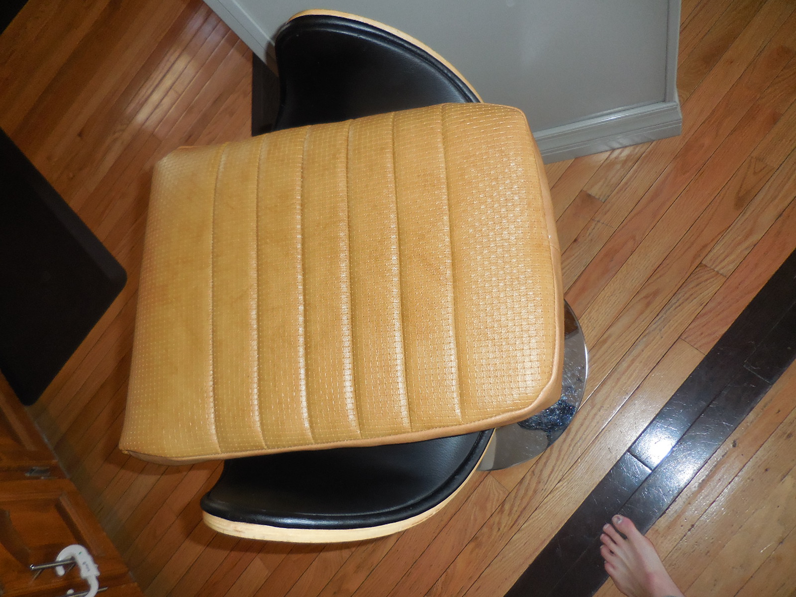

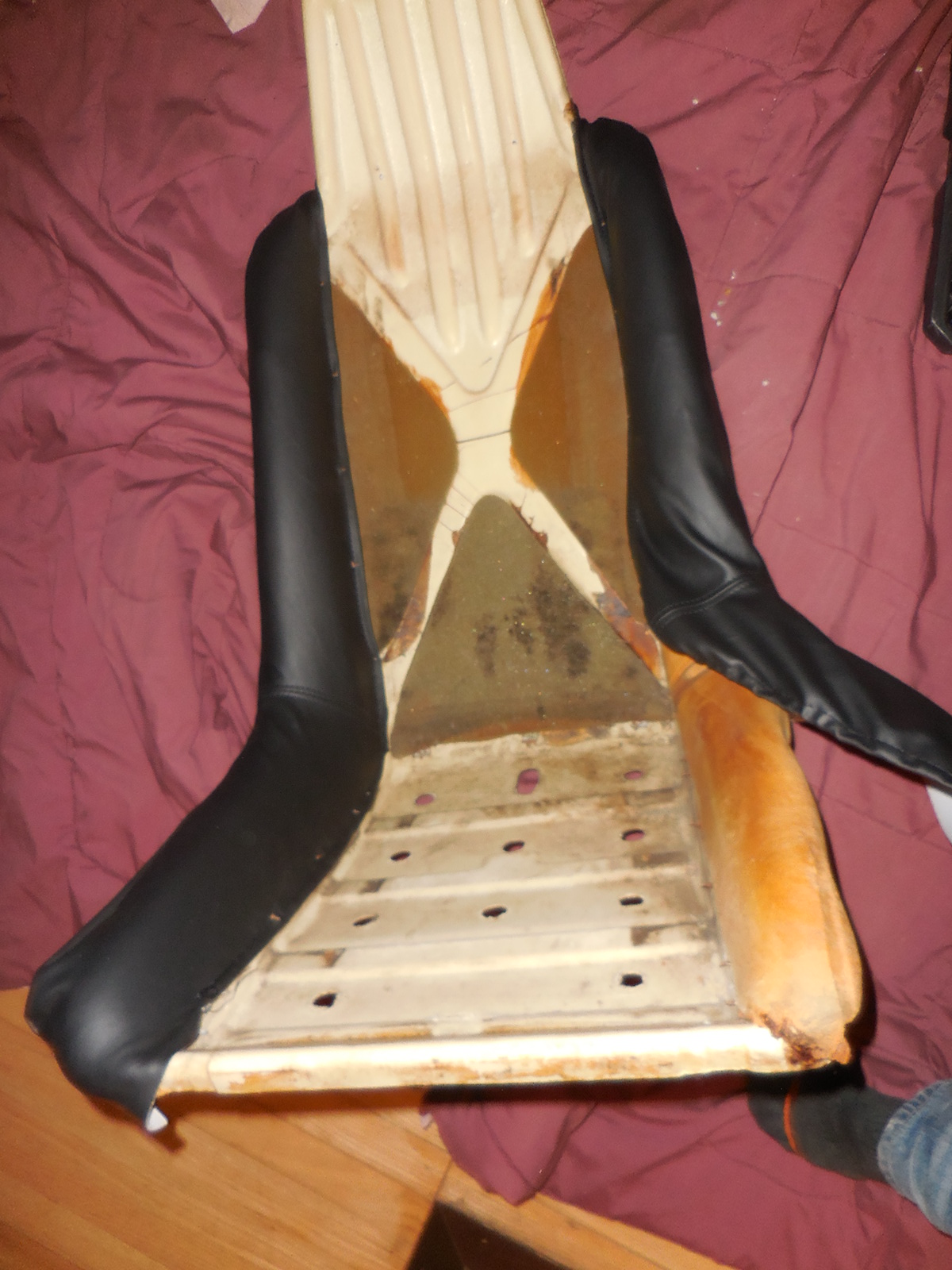

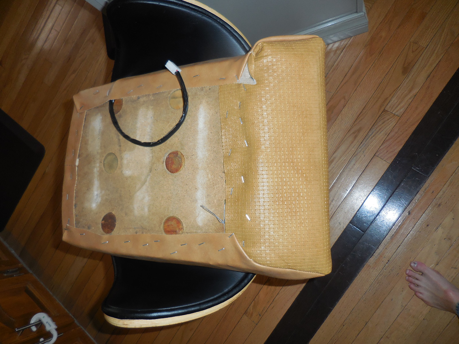

Spent the super bowl working on the seats seat and i get frustrated with myself for getting frustrated. I working painstakingly slow and one would expect my outcome to be comparable to a perfectionist.... but its not. Anyway spent an hour and got the back of one seat done. I had to screw some of the hooks back onto the "bone" of the seat. I will be adding seat heaters to these seats.
Screws going into hooks. I used #4-40x3/8" and i may have to grind off the lip on the back end.
First side down and hooks are in!
Both sides down.
And the completion of the bottom pads with seat heaters.

brettrarnold   Spent the super bowl working on the seats seat and...   Feb 4 2018, 09:47 PM
76-914   Looks great! May I make a suggestion? While yo...   Feb 5 2018, 09:35 AM
brettrarnold   Yep have the heated seat kits and put in the botto...   Feb 5 2018, 09:53 AM
mepstein   Yep have the heated seat kits and put in the bott...   Feb 5 2018, 10:52 AM
mepstein   Looks great! May I make a suggestion? While y...   Feb 5 2018, 09:38 AM
76-914   Looks great! May I make a suggestion? While ...   Feb 5 2018, 11:17 PM
brettrarnold   Ya not sure myself. I saw in the master seat upho...   Feb 5 2018, 11:20 AM
mepstein   Ya not sure myself. I saw in the master seat uph...   Feb 5 2018, 11:49 AM
