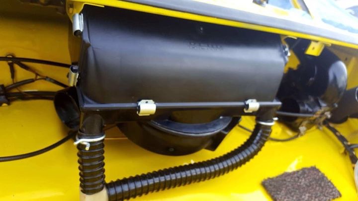

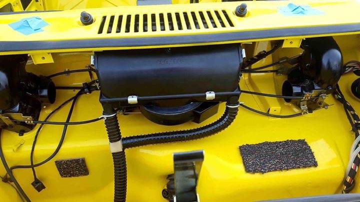

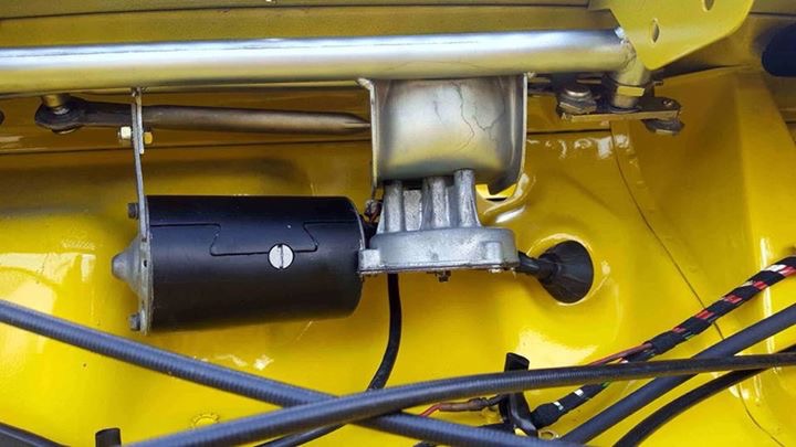

More work: installed vent and wiper mechanism
Bob B
Attached Image Attached ImageAttached Image
