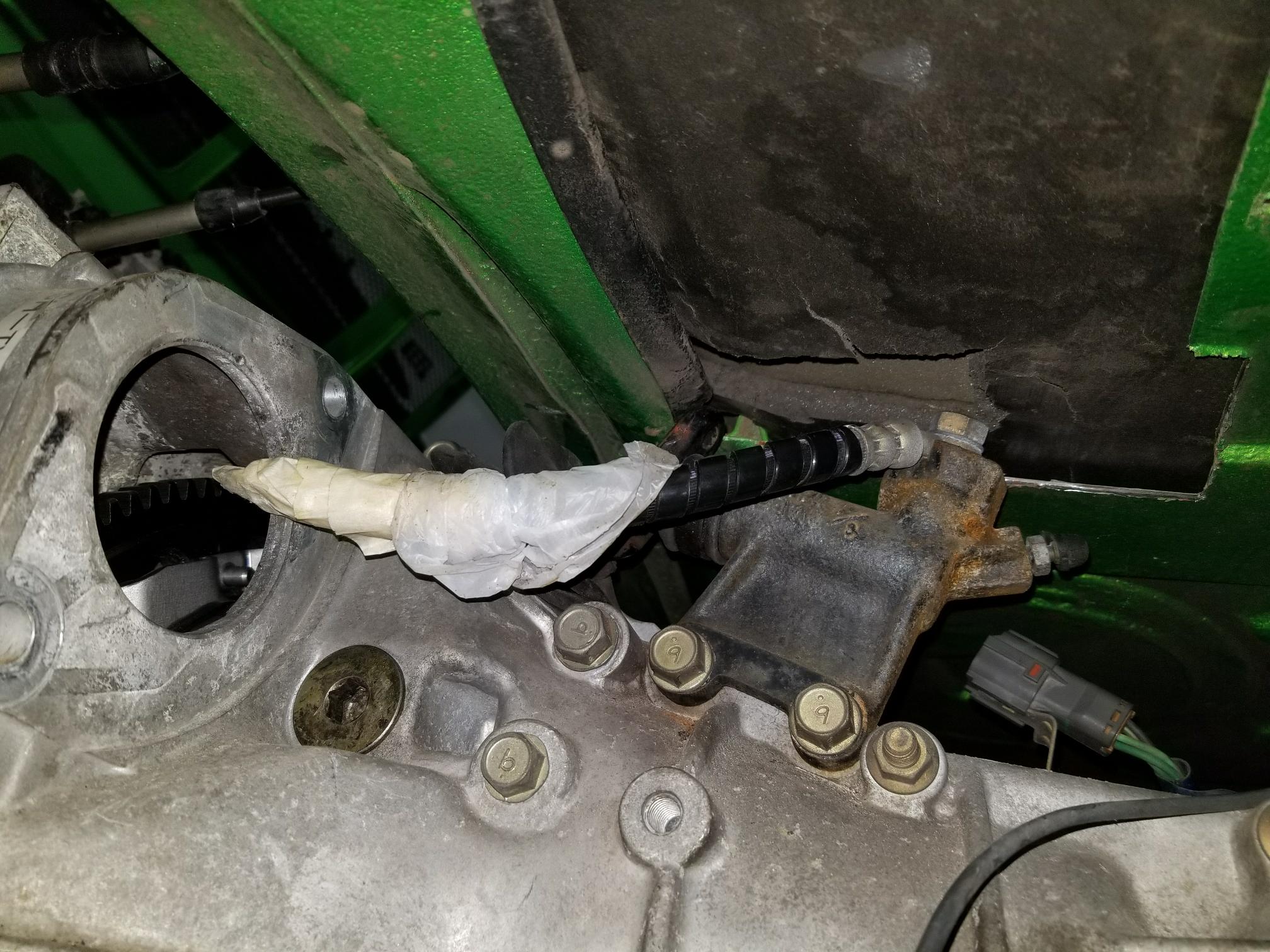

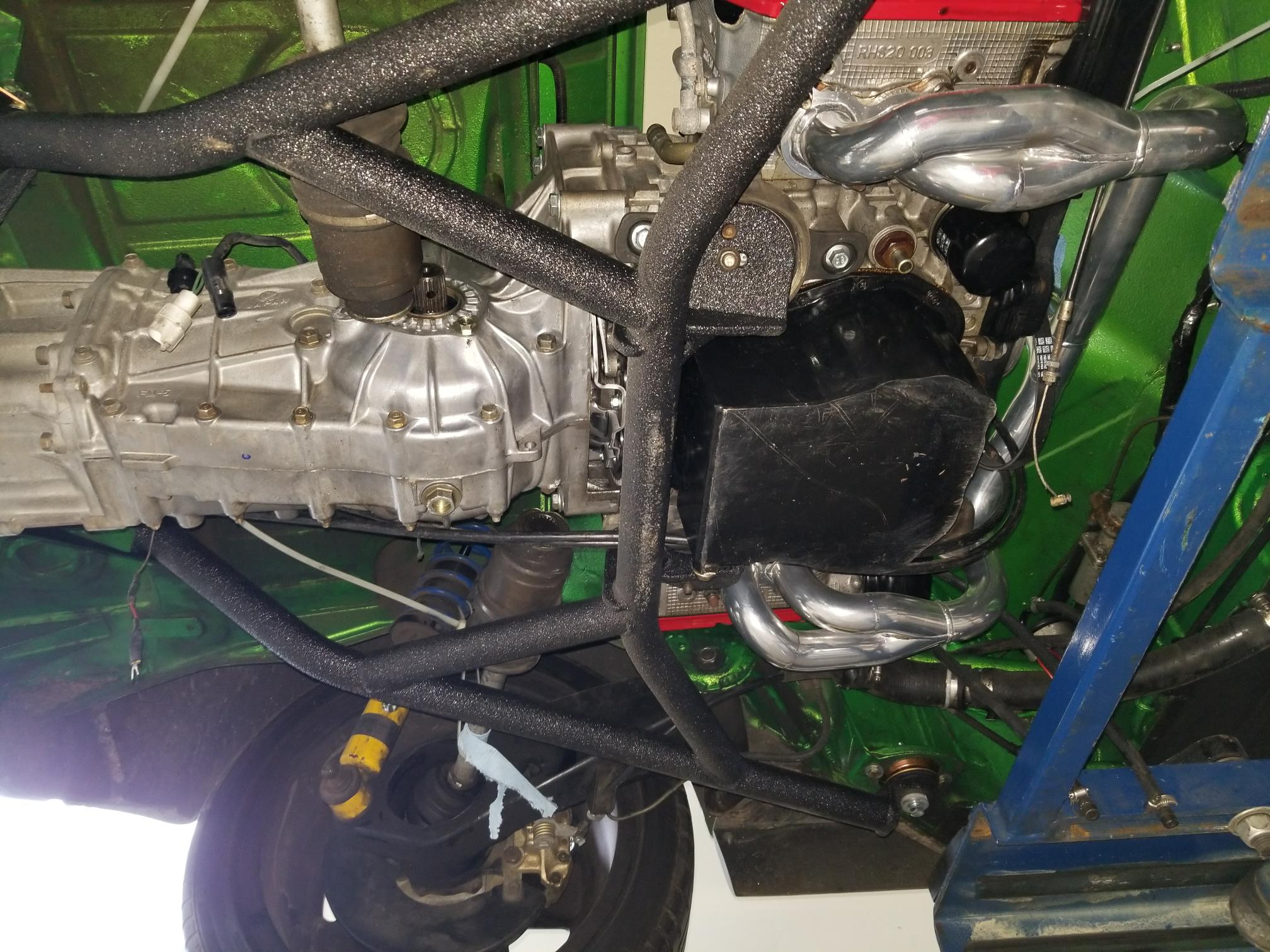

Well I had some progress today. I also had a setback.

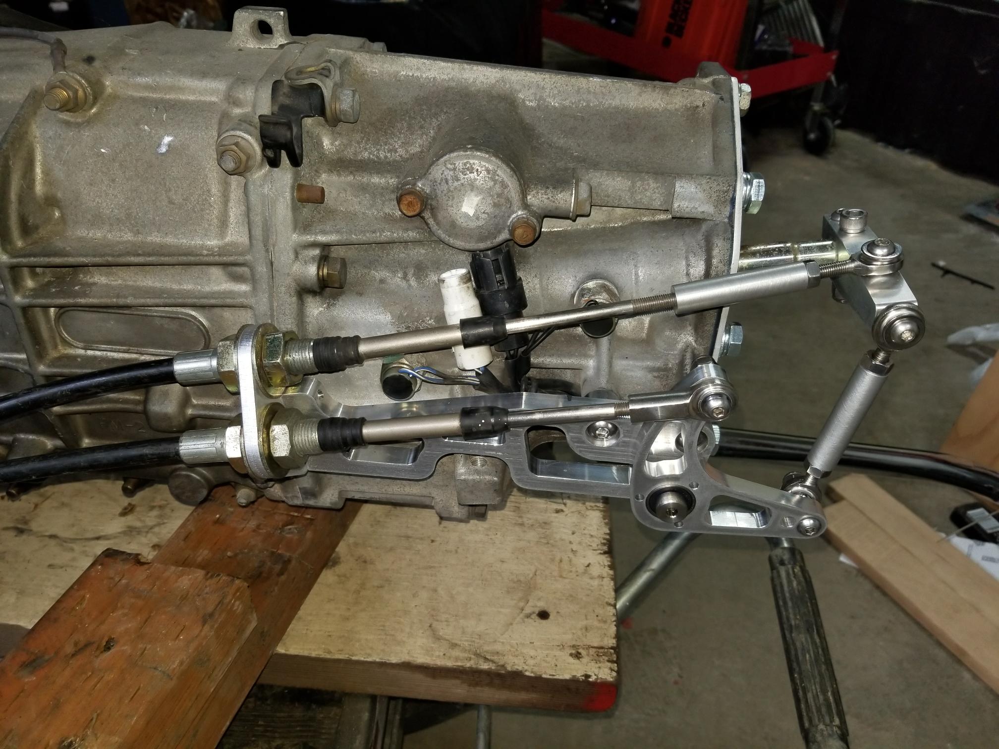

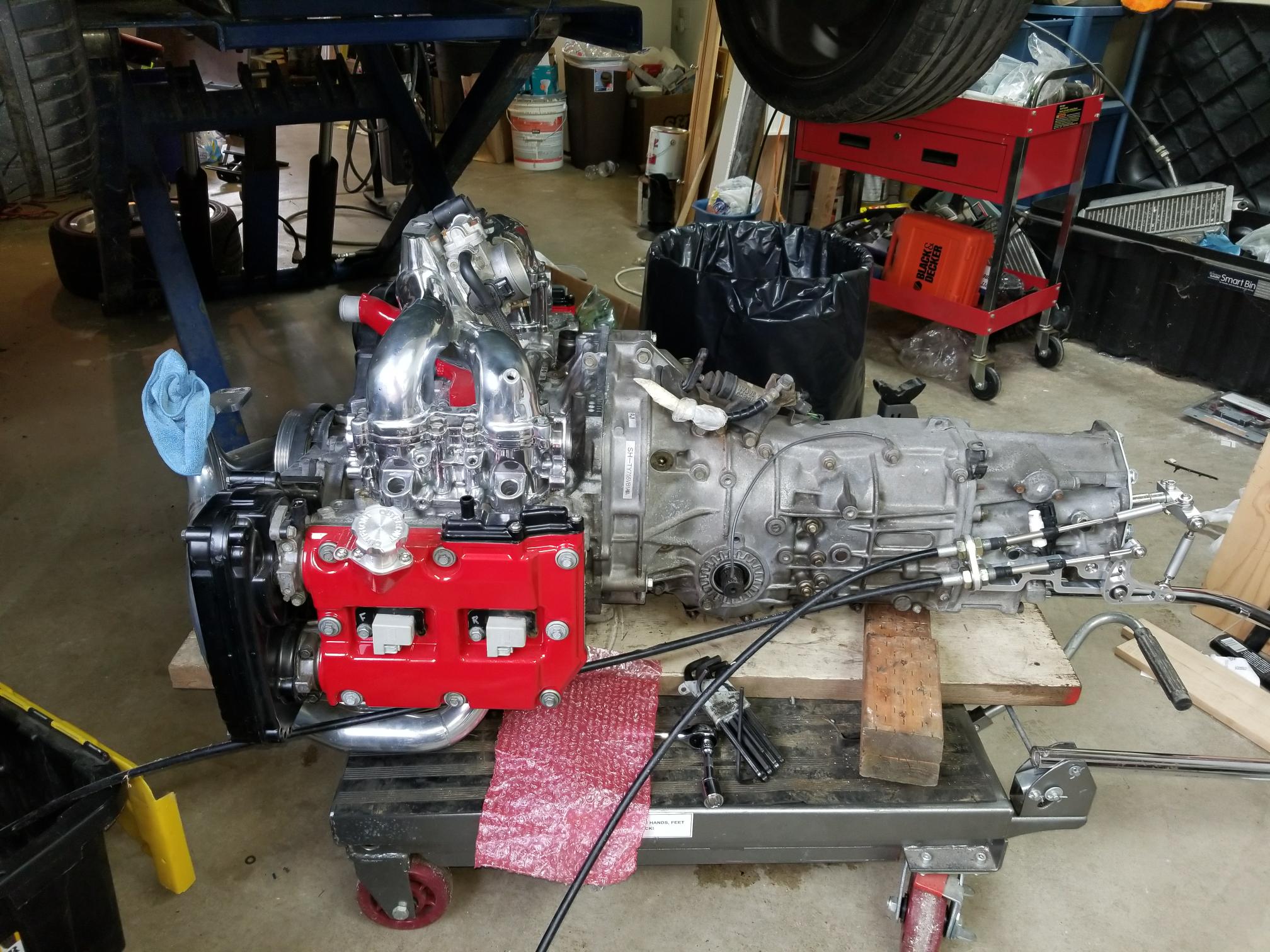

I got my clutch all done & installed. Mated my tranny back to my motor. Installed my zero decipals cable shift setup (with looks great). Didn't hook up to my shifter yet. Installed my cradle to the motor. Then using a combo of my mid rise scissor lift & my hydraulic table. I put it up into place in my car.
Which is where my problem is. My tranny ears don't line up & mount. Both my cradle & tranny ears are from Coldwater. Well I think they are. The tranny ears I got from my friend Brent. He was using a firewall mount. Talked to Ian & he is sending me another set of tranny ears to check. Basically my drivetrain is sitting 2 1/2 to 3" closer to the firewall than it should be. MY previous cut out in my rear trunk for my clutch arm definitely doesn't match where it was with my last motor. Also my motor isn't sitting level. My transmission needs to go up or my motor need to drop some to make it level. Either way I need to figure out how I am going to move my drivetrain back. Guess LineXing my cradle wasn't such a great idea without test fitting it first (IMG:style_emoticons/default/sad.gif)

Chris H.   Hmmm...that's weird. Can you post some pics o...   Feb 10 2018, 09:36 PM
JRust   Hmmm...that's weird. Can you post some pics ...   Feb 10 2018, 10:04 PM
Chris H.   Yes the engine sits farther forward with the cradl...   Feb 11 2018, 09:23 AM
JRust   I heard from Brent & he made those tranny hang...   Feb 11 2018, 07:55 PM
