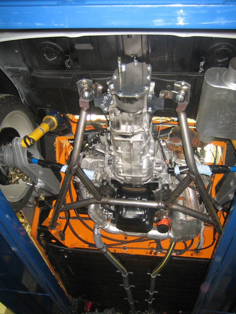

Hmmm...that's weird. Can you post some pics of where they line up (or don't line up) with the trans mounting points on the car? You sure you have the trans hangers on correctly? Should look like this:
Take a look at this thread, starting at post 266:
Orange car
Has some helpful pics. Same engine, same cradle.

JRust   Well I had some progress today. I also had a setba...   Feb 10 2018, 06:26 PM
Chris H.   Hmmm...that's weird. Can you post some pics o...   Feb 10 2018, 09:36 PM
JRust   Hmmm...that's weird. Can you post some pics ...   Feb 10 2018, 10:04 PM
Chris H.   Yes the engine sits farther forward with the cradl...   Feb 11 2018, 09:23 AM
JRust   I heard from Brent & he made those tranny hang...   Feb 11 2018, 07:55 PM
