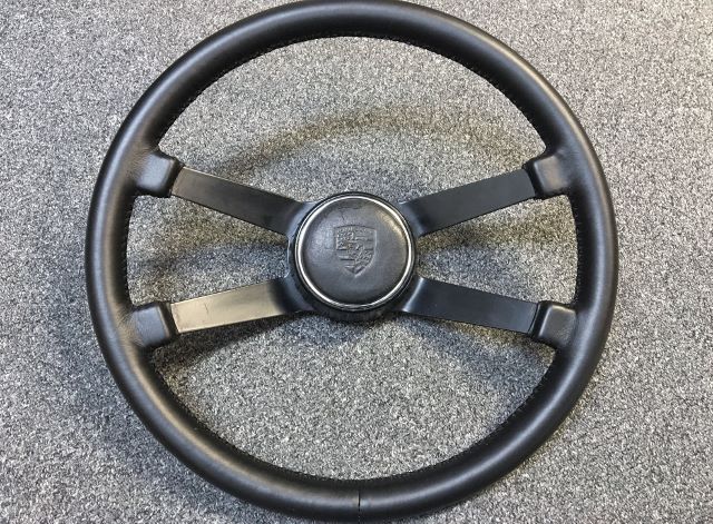

Mike Fitton
post Feb 11 2018, 11:29 AM
Posts: 648
Joined: 13-May 11
From: Mount Prospect, IL
Member No.: 13,069
What steering wheel are you going with? Here is one of mine 380mm and thick wrap to 3 5/8".
