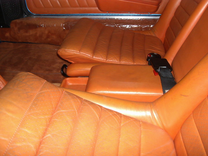

pete000
post Feb 11 2018, 11:31 AM
Posts: 1,887
Joined: 23-August 10
From: Bradenton Florida
Member No.: 12,094
I like the shortened center arm rest exposing the center tray.(also leather wrapped)
