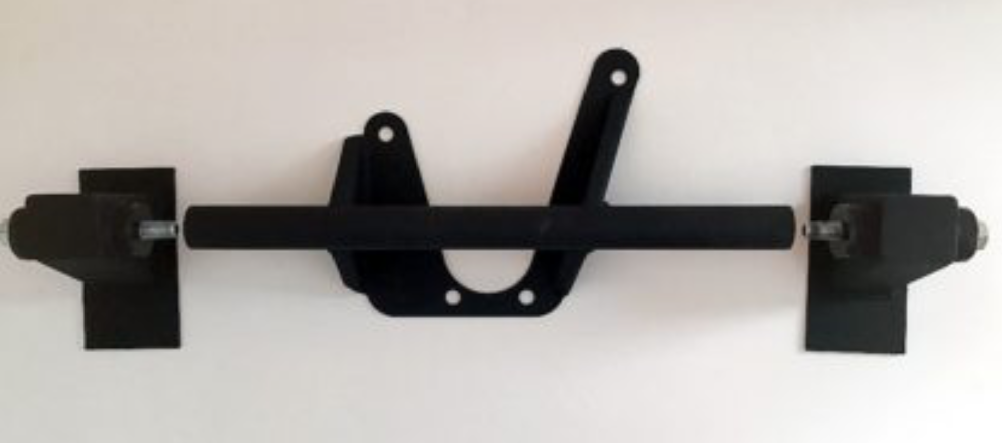

> Could someone take me to school on the merits of a bolt-on vs welding 914/6 engne mount?
Tdskip
post Feb 12 2018, 08:11 AM
Posts: 3,784
Joined: 1-December 17
From: soCal
Member No.: 21,666
Good morning - just doing some planning here but it looks (to my undereducated eyes anyway) that the weld-in and bolt-in mounts are similar. Do people use the Patrick Motorsports one simply to avoid welding?
It looks like a bolt-in one would need holes drilled in the firewall to mount it?
Thanks in advance for the schooling.

The setups appear similar. Why is the NaroEscape better? Just curious.

Steve   Correct. All the mounts are welded in, but the cr...   Feb 12 2018, 08:37 AM
Tdskip   Correct. All the mounts are welded in, but the c...   Feb 12 2018, 08:40 AM
Cairo94507   I think Naro914 has a great mount. For me, if you...   Feb 12 2018, 09:01 AM
patssle   Uhhhh - the PMS bolt in mount does NOT need to be ...   Feb 12 2018, 09:11 AM

naro914   The setups appear similar. Why is the NaroEscape...   Feb 13 2018, 07:10 AM
