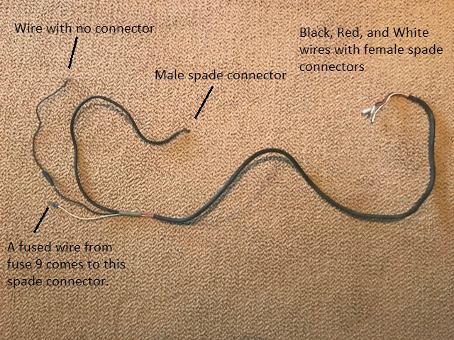

I had a closer look at the harness that, for some reason, I had labelled intermittent wiper (I probably looked at some documentation and erroneously concluded that must be what it was for). It doesn't look like that's what it was for and I don't recall if I disconnected it from anything but I'm thinking not. It is connected to the fuse panel at the front spade terminal of fuse 9. Then there is a fuse in line, then a branch with a short piece of wire with no connector on it, and then it connects to the rest of the harness pictured below at the spade terminal identified in the picture. The rest is as shown in the pic. Does anyone recognize what this harness would be for? It does look like an original, period correct harness...

doug_b_928   update: I see the unknown ground goes to the grou...   Feb 11 2018, 05:05 PM
Jeff Bowlsby   See wire 63 on the second page of the schematic. ...   Feb 11 2018, 07:01 PM
doug_b_928   Got it. Thanks Jeff! Looks like I'm th...   Feb 11 2018, 07:17 PM

doug_b_928   Today's question: I think I've figured out...   Feb 18 2018, 10:59 AM
bbrock   Today's question: I think I've figured ou...   Feb 18 2018, 01:35 PM
gothspeed   Today's question: I think I've figured ou...   Feb 21 2018, 06:53 PM
Jeff Bowlsby   Fellas, its a circuit. From the power wire, throu...   Feb 18 2018, 04:06 PM
doug_b_928   Makes sense, thanks Jeff! PS. Does the mystery...   Feb 18 2018, 04:12 PM
Jeff Bowlsby   Don't know about the mystery harness. It may ...   Feb 18 2018, 04:18 PM
doug_b_928   Perfect, thanks Jeff!   Feb 18 2018, 04:21 PM
