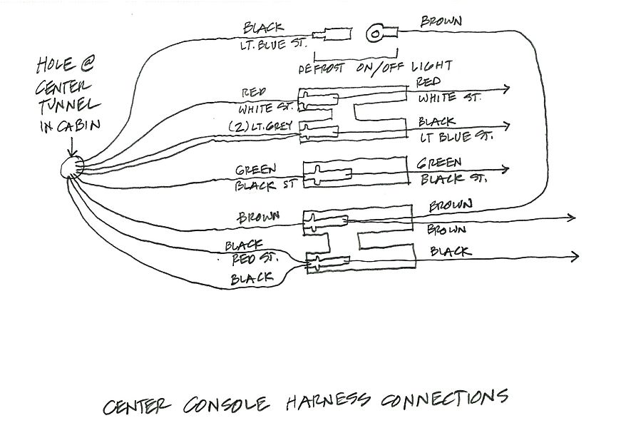

Exactly, so I figure I'll just make up a single ground wire with a female spade to connect to the appropriate ground at the main harness and with one of those little connectors with a hole for the screw at the other end of the wire (my car didn't have the center console gauges). Here's the image from Jeff's page. It's not the same schematic in terms of wire color as for our 73s, and on our schematic the black with blue is coming back from a double wire on the male spade in the insulator for the centre console.
I checked Jeff's page re the intermittent relay wiring and I don't think that's it. There should have been a brown with black lead for that harness and there's no relay socket on it.

QUOTE(doug_b_928 @ Feb 14 2018, 12:19 PM) *
No harm in adding that ground wire with ring connector, but I don't think it is necessary. The brown wire on the main harness side where the center console harness connects, runs back to the interior light (according to the diagram, and then to the chassis ground in the engine compartment. My hunch is the engineers decided to add that pigtail to ground on the console harness to provide a secondary, and closer ground as assurance the gauges would all have a good solid ground. I would further guess they were thinking mostly about the voltmeter although that goes a little counter to the crazy routing they chose to get power to the voltmeter. I'm confident the heater light will work fine with, or without that other ground, but it never hurts to add it.
