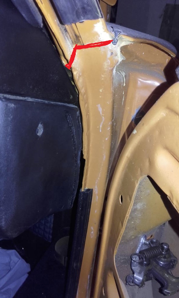

I put the lower dash pad on tonight and put all the underside screws in but left the side screws out for now.
I now have a gap in the door pillar edge seal. How far up does the edge seal go for a proper seal/fit?

Both seals (upper and lower) should meet at about the red line in this pic VVV

Mikey914   That seal is way too short.   Feb 16 2018, 12:54 PM
