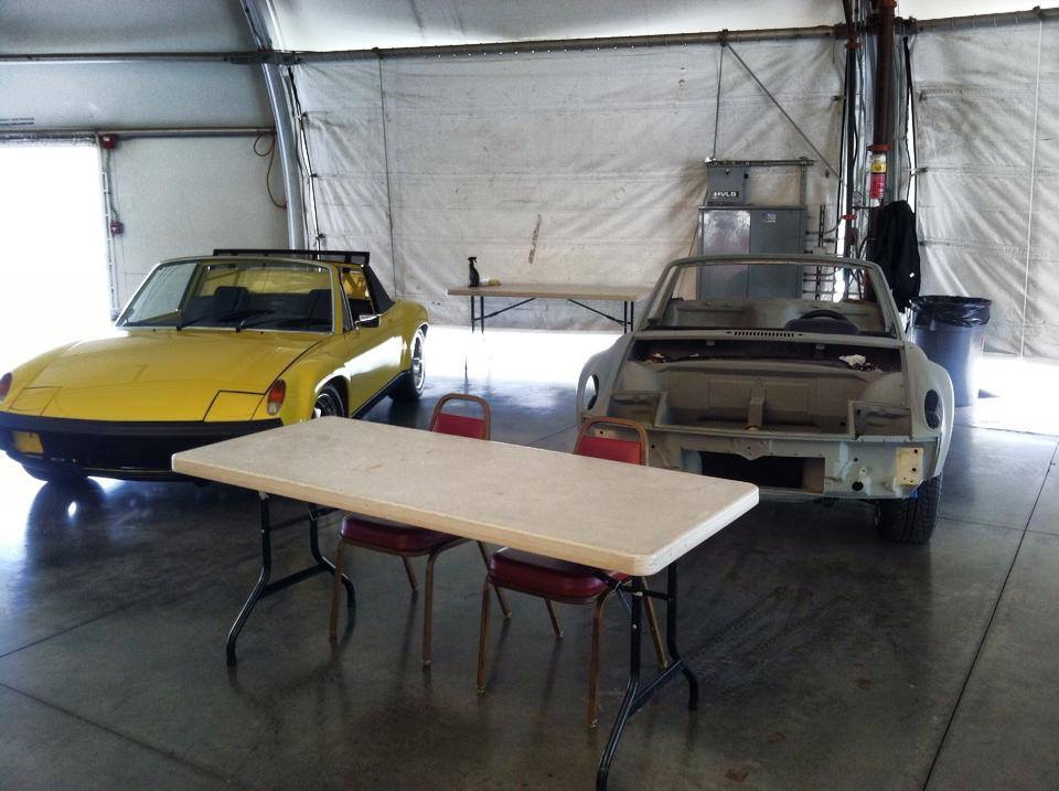

This was 4 years ago at Anaheim, CA The unveiling of Andy Thonet’s Cannery Yellow 914-6 and #41 on the way to PMB Performance
PMB will be there one more time at the indoor ... The All-Porsche Swap & Car Display will again be held on the day after the Lit Meet on Saturday, March 4th, 2018 at the Phoenix Club
If you want a PMB Restoration it takes some time to get a seat at the table.
Bob B
