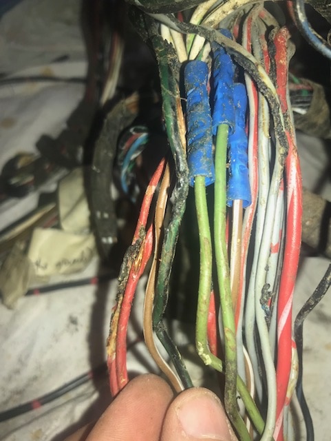

Upon further investigation, things make a bit more sense. The wire for the heater light was pretty much nonexistent at the location where the light would be, the wire was melted up to its power source at the light switch. Someone had spliced in another wire to it about 7 inches back from the headlight switch (with the wrong colour which made it confusing). Here's that splice with butt connector (black with blue in and grey with red out).

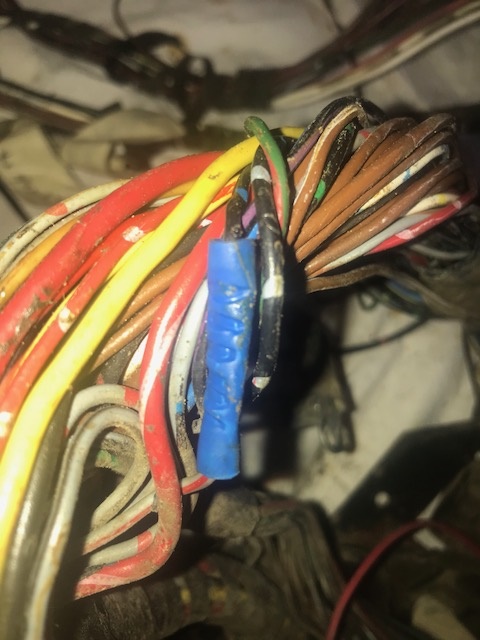

Other wires to/from the headlight switch seem to have been affected by heat. There are others with butt connectors and mismatched wires and a few others had electrical tape wrapped around missing/melted insulation. Here's a view of that:
So, does it seem like the wire overheated at the heater light, that wire got really hot, and then shorted by the headlight switch? Or, would it be the reverse with something happening with that wire at the headlight switch and melting other wires around it?
Either way, If I replace everything with good, and hopefully correctly colored, patches of wire, should I be good to go?
