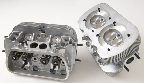

Has anyone done testing to understand the Net difference between single and twin plug on a /4?

Aero-VW airplane engines use the second plug as a redundant back up fail safe. Not for performance. They use a magneto for ignition.
