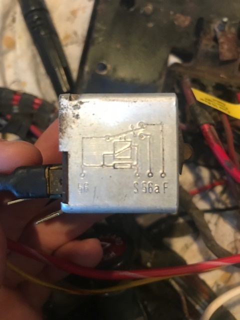

My extremely limited knowledge of electronics continues...I'm trying to figure out the relays. A PO had disconnected two wires (going to fuses 2--white and 4--yellow) from the combination relay. I'm putting everything back to stock per the wiring diagram. Here's the diagram for the combination relay:
So the wires should connect to the relay as follows:
White = F
Red/white = 56
Yellow = 56a
Yellow/red = S
Here is the schematic on the side of the relay:

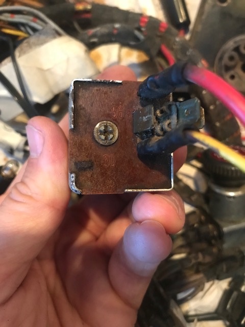

And here are the connectors on the relay:
The only code I can see that corresponds to the schematic is 56a, which is the spade in the middle.
So, the question is, how do I know which of the other terminals is which?
