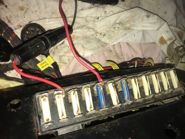

Hoping someone will chime in about my previous post in terms of how to read the relay schematic so I know which pins are which. In the meantime, the power antenna and radio were wired by soldering in wires with in-line fuses as shown below:
The Radio is wired to Fuse 8 which includes the cigarette lighter.
The antenna is wired to Fuse 11 which includes the interior light.
Is this an appropriate way to power these devices? I'm guessing that Fuse 8 (cigarette lighter) gets power when the key is turned on. But I wonder if Fuse 11 has constant power because it includes the interior light? If so, should I power the antenna from fuse 8 as well or does the radio itself tell the antenna to raise and lower?
Basically, I guess the main question is what's the best way to wire the radio and antenna into the original fuse panel?

doug_b_928   Hoping someone will chime in about my previous pos...   Feb 21 2018, 06:36 PM
doug_b_928   I just searched some old pictures and it appears t...   Feb 21 2018, 06:46 PM
bbrock   I just searched some old pictures and it appears ...   Feb 21 2018, 07:45 PM
doug_b_928   Thanks very much Brent. Yeah, after all of this I...   Feb 23 2018, 07:44 PM
Jeff Bowlsby   If my memory is right the radio clips to Fuse #7 b...   Feb 23 2018, 08:05 PM

Jeff Bowlsby   I know I have seen a harness with the radio at fus...   Feb 23 2018, 08:56 PM
doug_b_928   Thanks again Jeff! As an update, here's a...   Feb 23 2018, 09:01 PM
Jeff Bowlsby   Looks good. Hope you see now why I don't reco...   Feb 23 2018, 09:44 PM
doug_b_928   Thanks Jeff. So to make sure, no fire issues with...   Feb 23 2018, 09:49 PM
Jeff Bowlsby   I would not label them permanently, but I see no h...   Feb 23 2018, 10:10 PM
doug_b_928   Excellent, thanks Jeff. I'm leaving them for ...   Feb 23 2018, 10:16 PM
