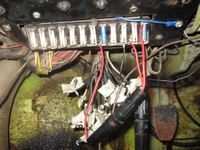

My main Winter project is to 'restore' the wiring harness on my 73. I admit that of all the jobs involved in restoring this car, this is the one that creates the most anxiety in me. I took it out of it's container last winter, spread it out on the floor, and promptly proceeded to put it back in the container. But, the time has come to conquer this thing. I have 4 rolls of wire tape that cost more to ship to me than the tape itself, and I think everything I need to do the job. I have pieces of a 74 harness (which I'm aware is not the same) and have already used one of the correct connectors from it for one of the license plate light connectors. Overall, I think the harness could be a lot worse, but there are some areas where POs have made some modifications/fixes and I'm not sure what they've done and why. I'll be asking for assistance from the wiring gurus in the thread as I work my way through. I have the wiring diagram from Jeff Bowlsby's website, a multimeter, PowerProbe3, and cleaning supplies. I'm removing all the tape, inspecting, cleaning, and then installing new tape. I'm just going to clean and inspect the rubber covered sheaths as they seem to be tight around the wires and it seems unlikely that there is anything wrong underneath them (on the upside, everything that ever worked on the car during my ownership, which wasn't everything that was supposed to, still did right before I removed the harness).
Okay, so with that introduction, my first questions. Starting at the back, I've worked my way through the license plate wires, to the trunk light wires, and I'm currently looking at the fuel pump wires. My car had vapor lock, so the fuel pump was relocated to the front of the car. The mechanic just cut the wires, left the ground wire dangling, and spliced in a positive wire which he ran through the firewall (poking a hole; no grommet), under the carpet and through a hole in the front firewall, where he then spliced in the connector and grounded to a screw he added to the front firewall. Here's a pic of the wires:
Because of the vapor lock issue, I'm thinking I should put my new pump in the front where the old one was (by the steering rack). I'm thinking of getting the NAPA Bosch fuel pump (N69133). From what I can tell looking at the wiring diagram, and I could be reading it wrong, the power wire goes to the 'regulator/relay plate). If it's source was at the fuse box under the dash I'd splice into the wire up there and put the original connector back on the wires in the engine bay (in case I ever wanted to put an original style in its original spot. If I'm correct about the wiring diagram, then, with my limited knowledge, I guess I have to run the power wire on the outside of the sheath (but at least it will be inside the new 914 rubber snorkel) and up to the fuel pump in the front? Is there any point in running the ground wire that way too, or would you just ground it to a screw on the car as it was before?
Also, in the pic above there is a green wire that looks like it had a connector on it at one time. Does anyone know what that was for? When I look at the 73 diagram it only shows the black with red dots and the ground for the fuel pump. On the diagram it shows the, IIRC, 'fan blower motor' having a green wire. However, if that's referring to the blower motor for the heater, I think the wires and connector below were for that (note no green wire).
So, to summarize, what's the best approach for the fuel pump wiring, and what is that green wire for?

I just searched some old pictures and it appears the modified wiring originally looked more like this?
So, it looks like fuse 12 (on the direct connection to battery side) was wired to an inline fuse that then went to the fuse 8. Not sure why they did this.
The antenna was powered from fuse 11
And probably the radio was powered from fuse 10...
So, to instead of figuring out what the PO had done, again, the best way to ask is, what is the correct/best way to wire in power for the antenna and radio?

QUOTE(doug_b_928 @ Feb 21 2018, 05:46 PM) *
Yeah, it's ugly to say the least. For starters, I'd put female spades on the radio and antenna wires and slide them onto the back of the fuse panel the proper way. There are several slots that have extra lugs for plugging in extras both before and after the fuse in the panel. I don't understand the jumper between fuse 12 and 8. Seems like a bad idea.
Somewhere I thought I ran across which fuse the factory radio harnesses plugged into, but for the life of me can't remember where, nor whether a modern radio would draw more power than whatever the factory or dealer would have installed. If nobody comes to the rescue with an answer, I'd be inclined to leave the inline fused in place, and plug them into whichever fuse has the fattest wire coming from the battery and an extra lug BEFORE the fuse. That way the radio and antenna would be protected with the inline fuses without running current through the fuse on the panel and possibly overloading it. I've never had an automatic antenna, but can't imagine they draw much power and how often are they operating anyway? I'd be inclined to twist the radio and antenna wires together and crimp a single female spade on the pair.
Now let's see if Jeff or anyone jumps in to point out how full of (IMG:style_emoticons/default/stromberg.gif) I am. (IMG:style_emoticons/default/biggrin.gif)
