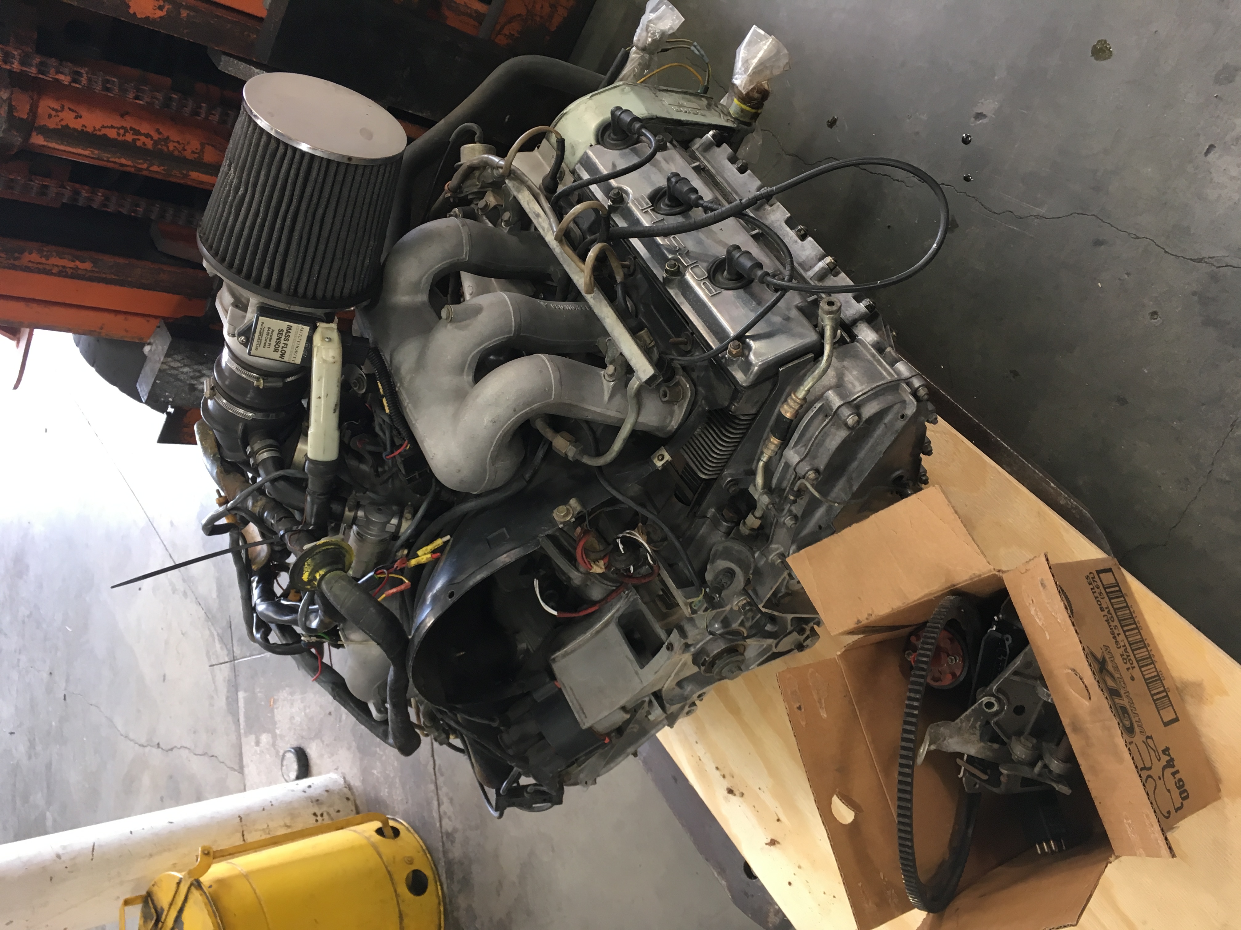

Good morning, can we pretend for a minute that I was going to do a 914/6 build with a 1974 that is already missing its engine. Further, can we imagine that I would be trying to build a car that would be used rather than showed, and that building a clone and/or a "correct" car is not a goal. The goal would be a well balanced, reliable and sorted out car for backroad touring use.
Does this look like the necessary bits?
-2.7 or 3.0l engine with CIS (have this)
-engine tin
-oil tank
-front oil cooler
-to/from oil cooler lines
-throttle linkage
-fuel pump
-fuel lines
-engine lid latch relocation bits (due to CIS)
-headers
-flywheel
-ECU
-CDI box
-O2 sensor
-Engine mount
-320i front brakes since the extra horsepower probably deserves it
Edit - adding these from Cario and Defianty
muffler
thermostat for the oil cooler
gauges to work with new engine
Filler neck for the oil tank
Oil dipstick
Oil filter console
Six muffler
19mm master cylinder
FI harness (missed that one)
Edit - adding from Lucky9146
Conversion Wiring harness?
914-6 trans mid-plate for throttle or some other contraption, not sure w/FI
Shift Rod modified for headers
Oil cooler thermostat
Oil cooler shroud
Oil Cooler Fans
Oil Fed chain tensioners
Edit - adding from mb911
headers or heat exchangers
Am I missing anything? I did try searching and reading prior discussions.
Thanks!
