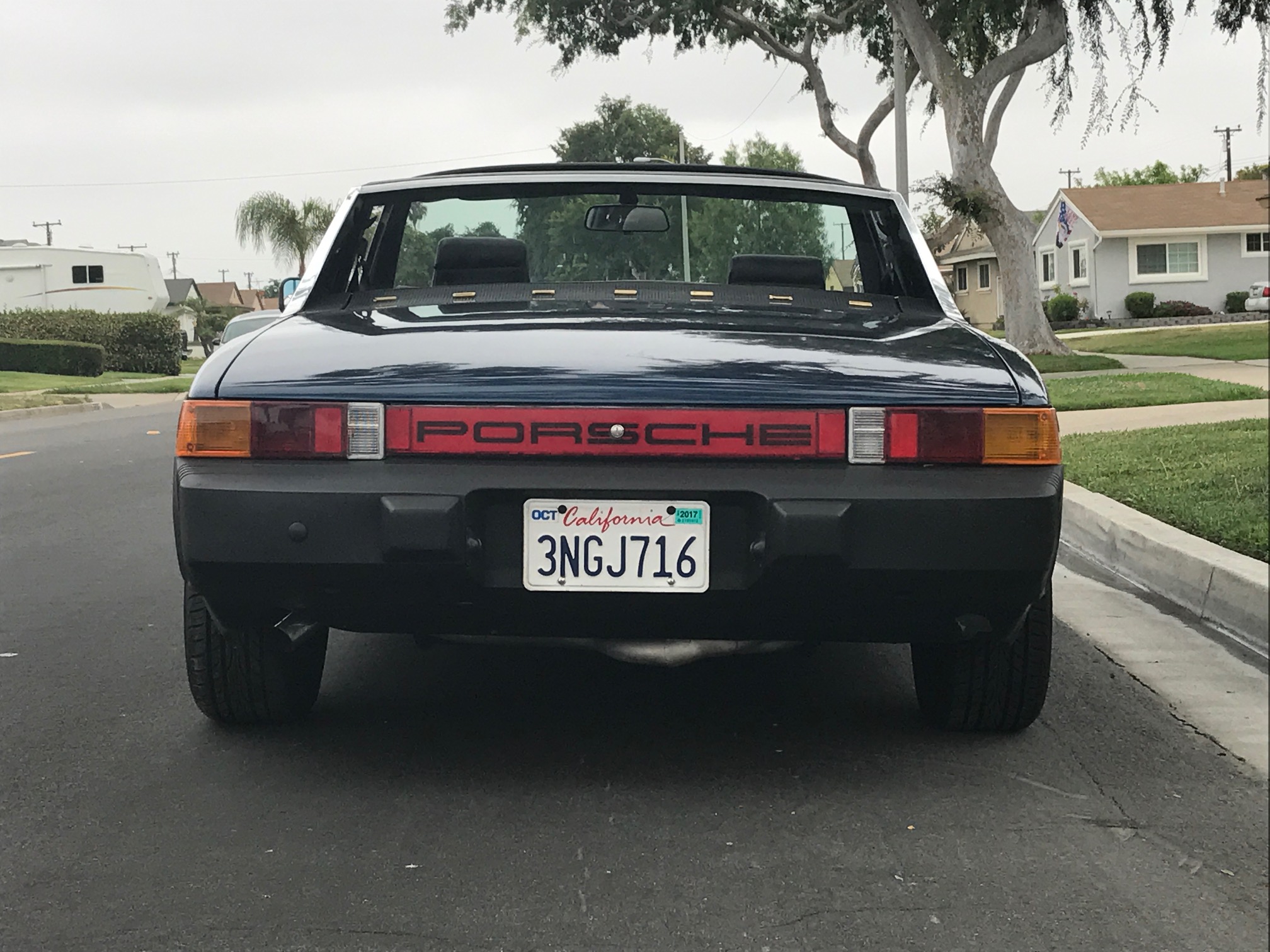

Usual rear trunk button has been replaced with a cable release from the cabin to make way for the aftermarket rear reflector. Please note: this is the mechanical CABLE RELEASE, not the electric solenoid that some kits used.
First sunny day in a while. Put the roof in the rear trunk. Never sure I'll be able to get it open again. Now it's time to park. Pulling the cable in the cabin, hear a clicking sound but trunk still seems to be latched. Cannot secure the car.
Anyone else had this experience? The reflector sure looks cool, but I'm not sure it's worth this hassle!

Or you can just drill a hole in the reflector and install back original key latch like what I have on my previous 75.
