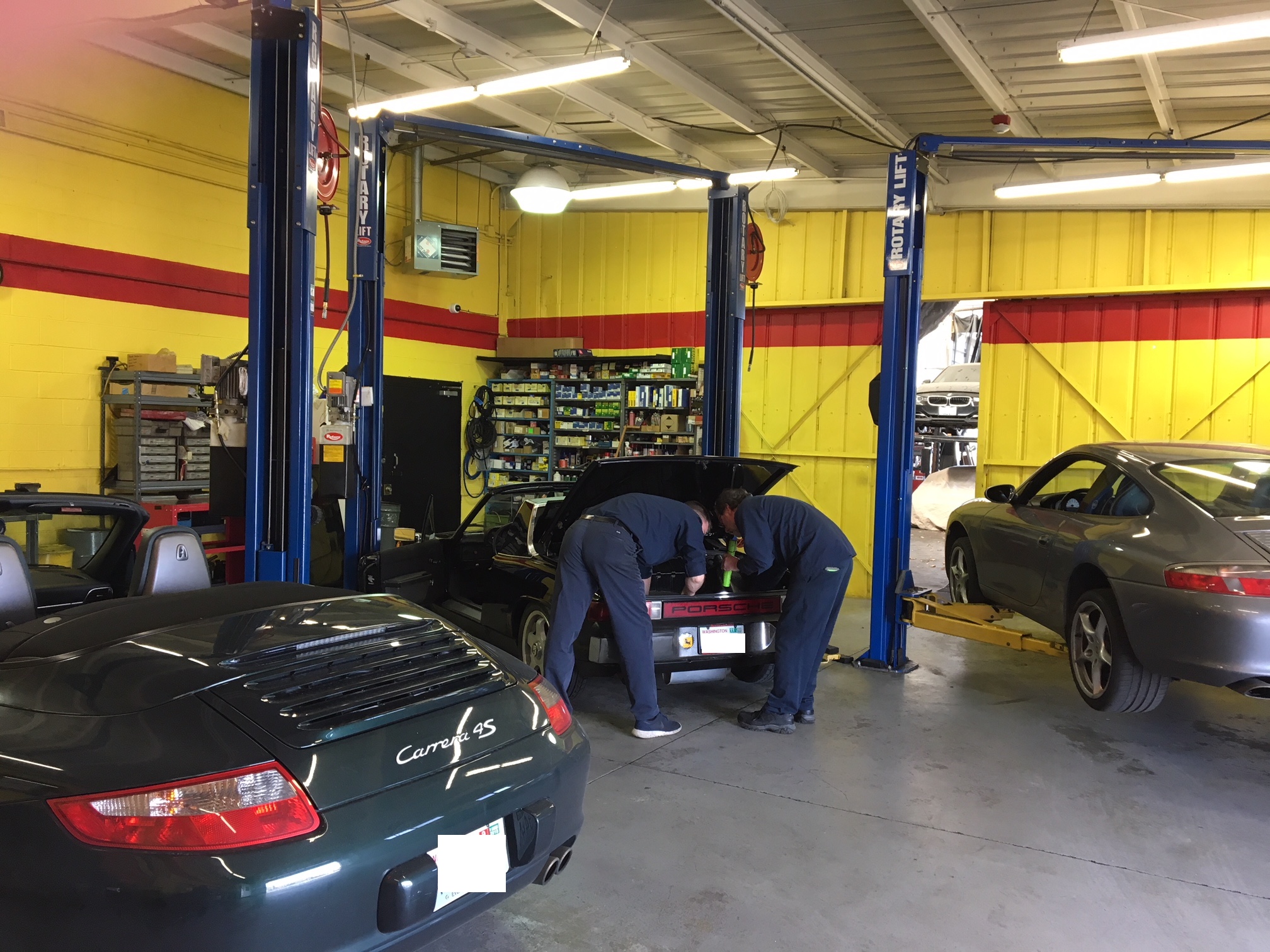

UPDATE: Mechanics at Gerber Motorsport were able to unjam it. "No magic. Just a whole lot of force."
Anyway, I'd probably just stick with the stock button release unless you really need that 1983 look.
