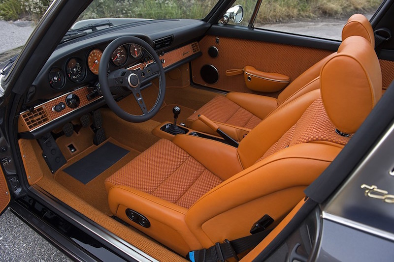

I like the look of the Singer interior in this color. I am getting samples of leather weave.
My car will be one of a kind. Looking for an update from PMB
Bob BAttached Image

burton73   I like the look of the Singer interior in this col...   Mar 16 2018, 06:00 PM
Cairo94507   :drooley: That is a great looking interior. :beer...   Mar 17 2018, 06:38 AM
76-914   :drooley: That is a great looking interior. :bee...   Mar 20 2018, 05:28 PM
