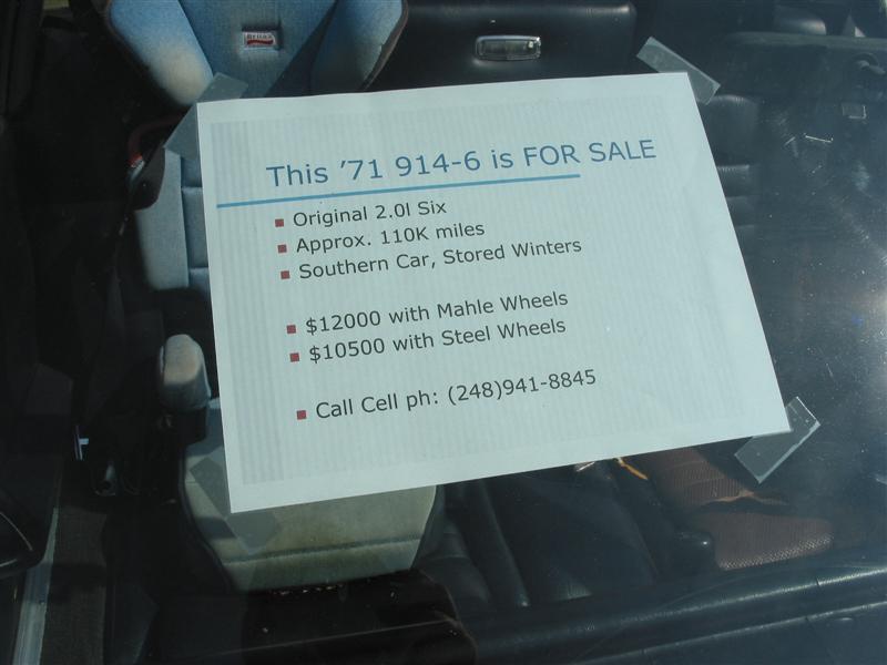

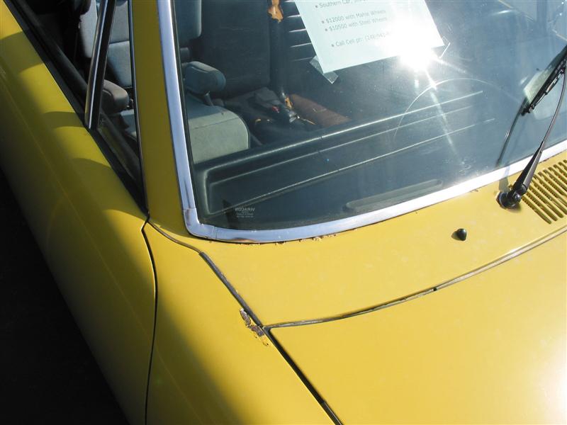

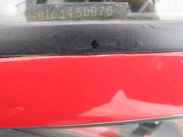

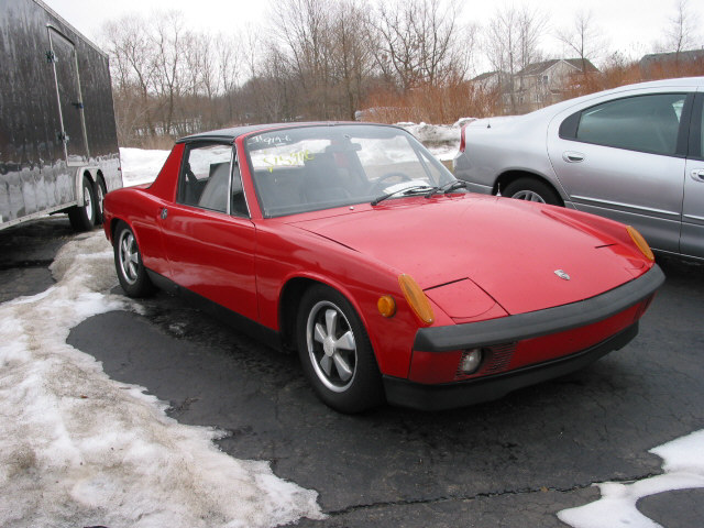

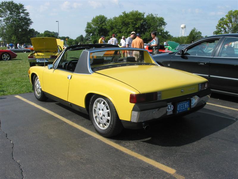

Hey,
I've often wondered what happen to these rusty rat (2) 914-6's FS locally in 2003??
I didn't think they were worth the money (IMG:style_emoticons/default/blink.gif) back in 2003 (IMG:style_emoticons/default/popcorn[1].gif)
