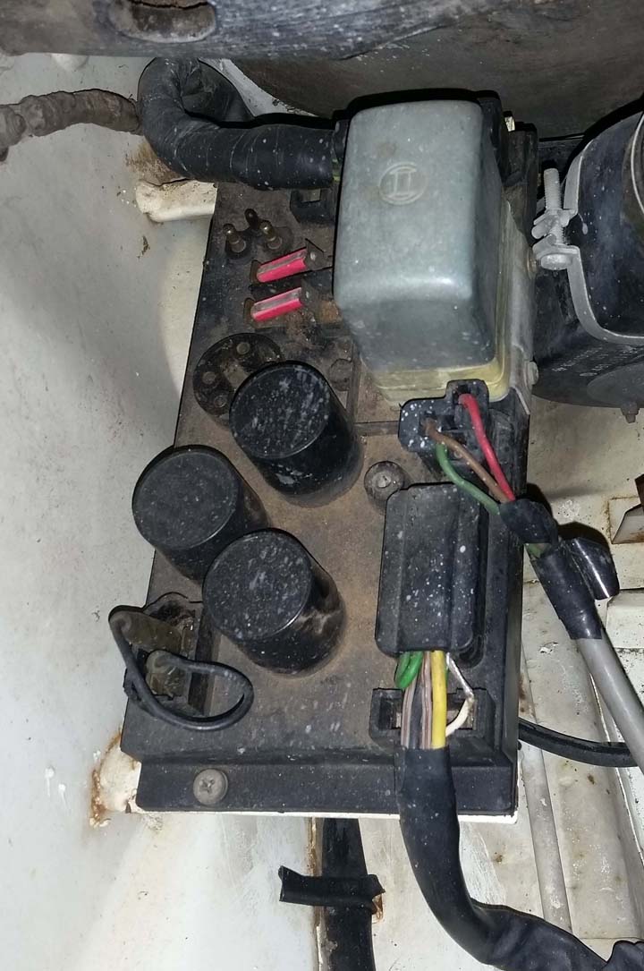

Back by popular demand, Sir Andy's "HOW TO" series presents:
HOW TO: Run the fuel pump for carb conversions
There are numerous tech. articles out there that cover this issue.
When you switch from the stock FI to carburetors, you have to install a low pressure carb fuel-pump.
But, since the FI fuel pump is controlled by the FI brain, removing the brain means the wires to the fuel pump won't give you 12V ...
There are a lot of "band-aid" solutions out there, some people remove the pump relay and add a jumper there, others even run the pump off the coil!
While all those solutions work (more or less) they all lack one thing, you're now running the pump without a relay! (and in case of the coil, without fuse as well)
The best (and also easiest!) solution is to trick the relayboard into believing that the FI-Brain is still connected ...
And it's as simple as connecting one wire from the 4-prong FI connector to ground.
You keep the stock fuel pump relay and fuse and you use the stock wires to power the new fuel pump.
Below you'll see 2 pictures showing how to attach the wire. on the pump side, simple make 2 more extension wires with "male" connectors on one end and plug them into the stock (roundish) plug for the stock fuel pump.
No need to hack into the original harness!!!
This install is clean and simple! (and cheap!)
In the pics below the thick red wired replaces the FI-Brain ...
(IMG:style_emoticons/default/smash.gif) Andy
(IMG:http://www.914world.com/bbs2/uploads/post-11-1109378319.jpg)
(IMG:http://www.914world.com/bbs2/uploads/post-11-1109378417.jpg)

So what's the correct fuse size for the fuel pump?
SirAndy has an 8amp, Elliot has a 16amp, the wiring diagram shows a 25amp and I have a 16amp (which may make sense as I don't have rear defrost)
On the same note, what's the upper fuse position for? It's blank in the wiring diagram

QUOTE(Noonan @ Apr 6 2018, 08:27 AM) *
If you look again, you can see that i have a blue fuse in there, the white one is in the top slot, which if i recall correctly is for the optional rear window heater.
Noonan
post Apr 6 2018, 11:10 AM
Posts: 5
Joined: 8-October 16
From: Colorado
Member No.: 20,478
Oh yeah, there it is, had to zoom way in.
Thanks!
