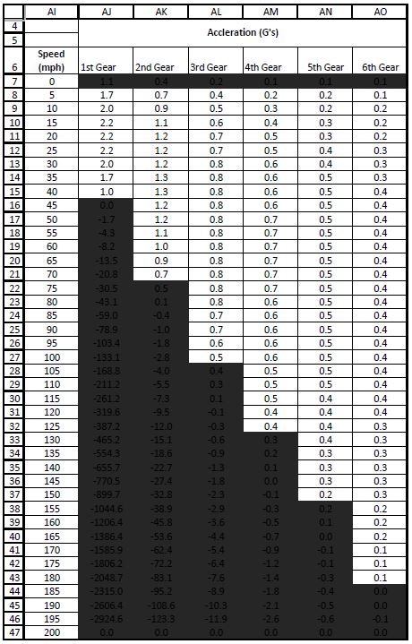

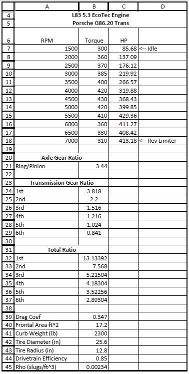

I have been tied up doing transmission repairs on my daily, a 06 Subaru LGT. So in the mean time I've been playing around with an excel sheet left over from a college assignment. The idea being to get an idea of how the Boxster gearing plays out with a 914 and 5.3L EcoTech. Hopefully, the screen shots are legible.
Here are my inputs. Note that the 7000 rev limiter is high. Realistically, 6500 would be a better limit point with valve spring and push rod changes for the 5.3L to live happily.

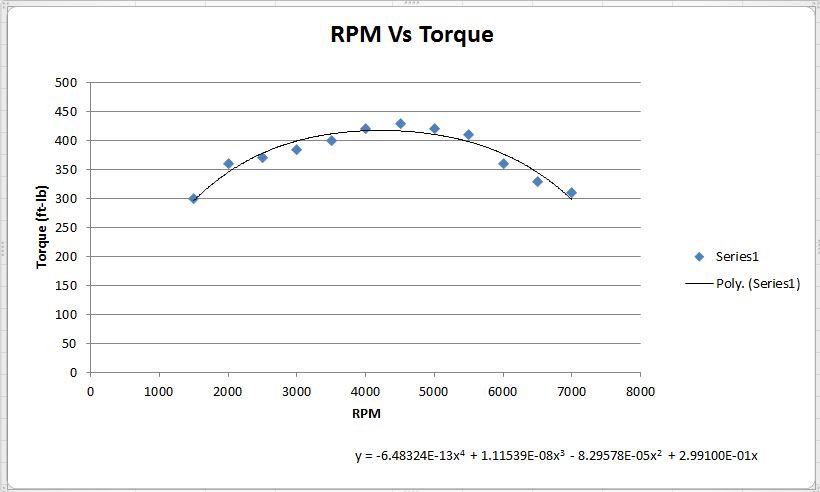

I pulled my torque data from the stock graph shown here
2014-2016 CHEVY/GMC SILVERADO/SIERRA 5.3L 1500 TEXAS SPEED & PERFORMANCE L83TR-2 CAMSHAFT
Plotted my points and calculated and equation
Found gear ratio's for the G86.20 trans from here
PORSCHE 986 BOXSTER TRANSAXLE SPECIFICATIONS

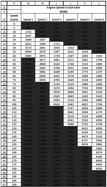

Below shows engine speed in each gear. Note this is for a rear 275/40R17 tire. (flares are definitely in my future) The blacked out area's are above the rev limiter or below idle.

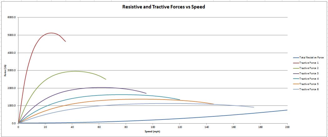

Using the equation calculated above and the gearing for the G86.20 determined the force the tire could potentially exert on the road in each gear "tractive force". I then used the drag coefficient and frontal area found in this link...
Cassidy-Online Areodynamic Aids
... to determine aerodynamic drag for the range of speeds shown. Note the drag coefficient and frontal area are for a narrow body car without a spoiler or front splitter. So realistically, I imagine the drag force would be higher. I also calculated a force induced by rolling resistance of the tire for range of speed shown. However, I feel less confident in that calculation but figured it plays a role so I included it. Below is a graph of "resistive force" (areo + rolling resistance) and "tractive force" in each gear shown in the Y axis and speed in the X axis.
Subtracting the resistive forces from tractive forces gives an overall force applied to the car causing acceleration. Using the weight of the car (~2300lbs) you could come up with an acceleration in G's shown below in each gear, at each speed. Again, blacked out area's are either above 7000 rpm or below idle.
It's probably worth taking all this with a grain of salt.. there are a million and one variables not included that could affect any of the above. The car probably won't accelerate at 2G's either. More likely is a smoke show and a slightly smaller tire diameter. (IMG:style_emoticons/default/aktion035.gif)
