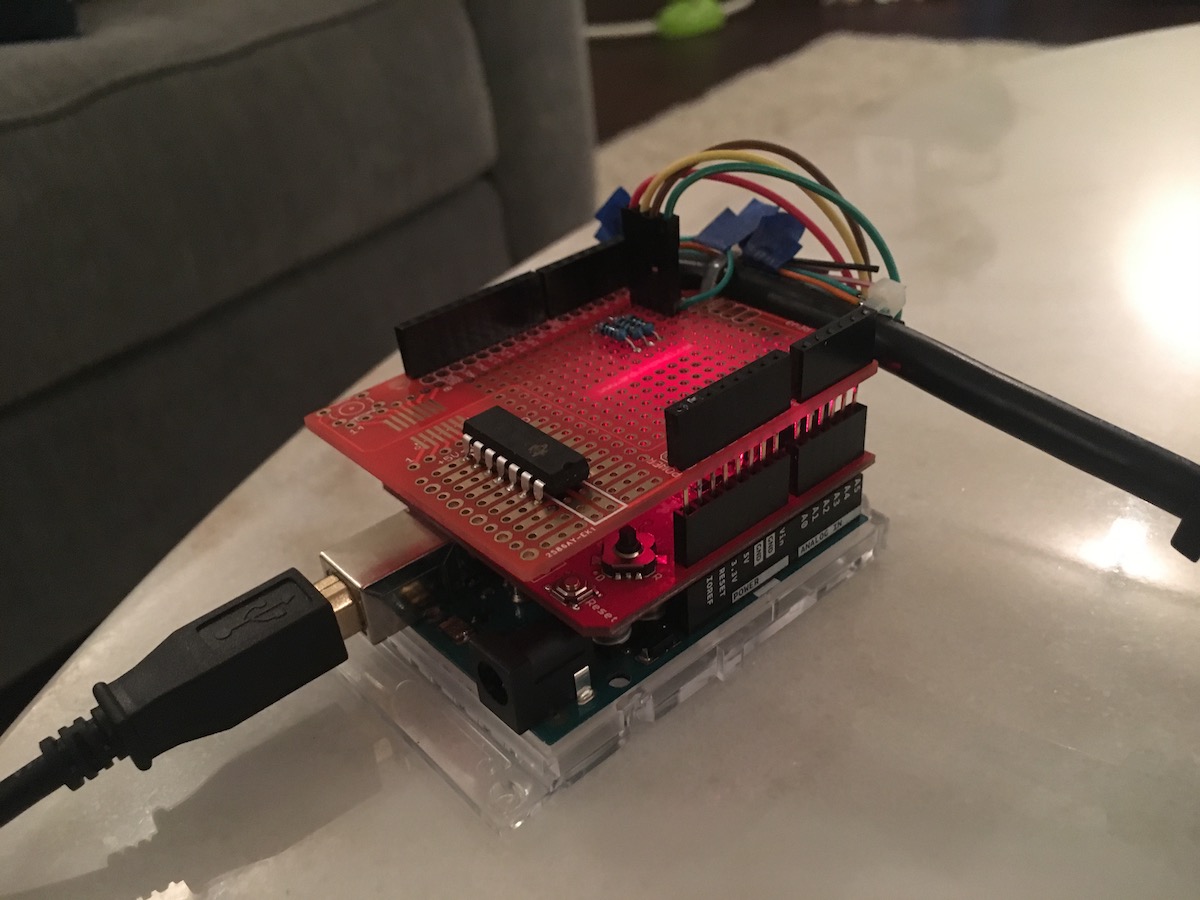

A bit more about the RaceCapture: Bought a used RaceCapture Track module from eBay and it came with a bad wifi module. $10 and an hour with a soldering iron and a new wifi module is installed and the Racecapture works as expected.
Next problem: Older Subaru ECUs don't speak CAN bus. They speak a Subaru-only message format called SSM. This means that I can't just plug the RaceCapture into the OBD2 port and get signals. There is, however, a project out there which uses an Arduino to translate SSM to CAN:
https://github.com/rpkish/Subduino-SSM
I've started building one of these and I've made pretty good progress. Im able to send test signals from the Arduino to the RaceCapture and have the data appear on the tablet dash. The next step is to wire up the SSM side and plug into the ECU.

MichiganMat   Time for an update! Been busy with a few thin...   Apr 12 2018, 02:07 PM
Mueller   Cool adapter you are building for the communicatio...   Apr 12 2018, 04:30 PM

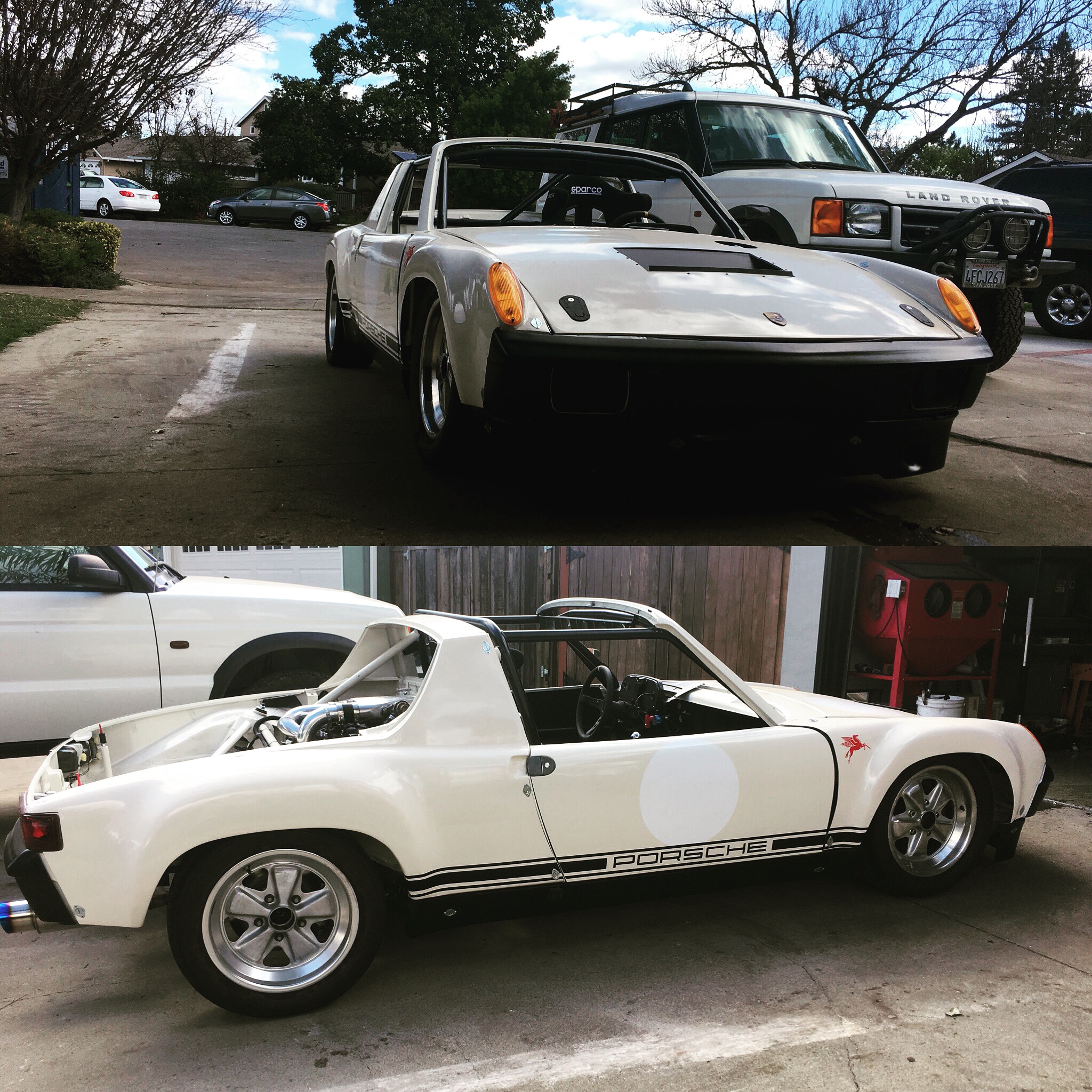

MichiganMat   It lives. First track day for the car is in the b...   Nov 18 2018, 12:01 AM
ConeDodger   P It lives. First track day for the car is in the...   Nov 18 2018, 09:11 AM
raynekat   Car looks and sounds great. Yeah, get that handlin...   Nov 18 2018, 12:34 AM
MichiganMat   Heres a pic of the car in the paddock @ Sonoma. S...   Nov 18 2018, 08:53 AM
914forme   Great to see the car get out on the track, that is...   Nov 18 2018, 09:50 AM
