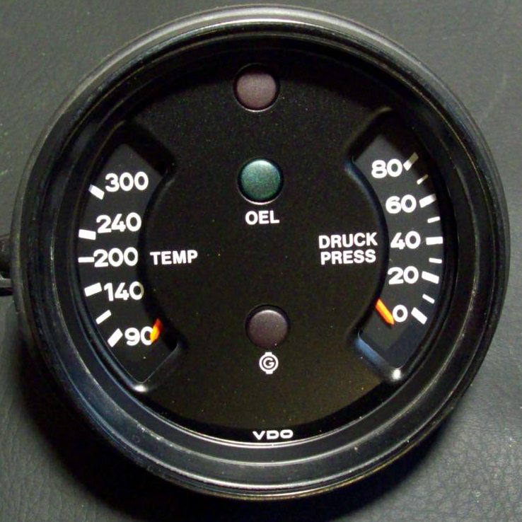

Started with the dies from an earlier attempt. Smooth out the old and mill the new
I bought a rotating table and the mill for this project. Well and other things too
First step was making the clamps.
I also made a punch so the I can start with the holes for lights and maintain registration
That gives me this:
Ready to press. I spent a lot of time setting things up for a pin router to cut out the gauge windows, but that didn't work out. So I have the dies and the sheet ready to form.

I have a question. Why to two different scales. Oil temp is in degrees and oil pressure is in bars. Why not make the pressure 0-80 psi ? New Vintage USA makes them. $30

914Sixer   I have a question. Why to two different scales. ...   Apr 14 2018, 09:00 AM
worn   I have a question. Why to two different scales. ...   Apr 14 2018, 10:48 AM
