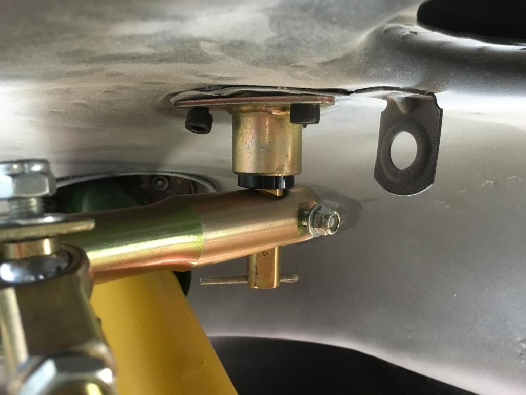

This sway bar here
My driver side looks like this
And my passenger side looks like this
Seems to be some room on either side of the bushing cup totaling abut 1.75 in. for the bar to wander off to one side as mine did. (IMG:style_emoticons/default/confused24.gif)

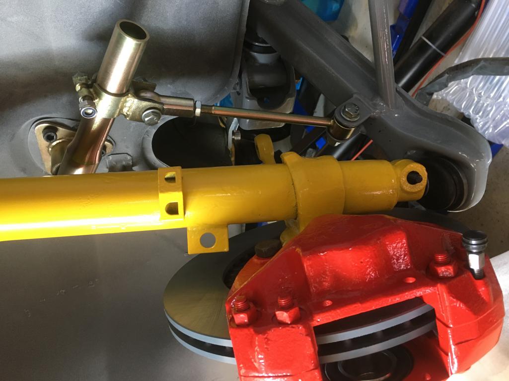

I took a good look at mine and although this is only a test build things seem to to snug up nicely. I could detect no play between the bushings. here are some pics:-

QUOTE(wysri9 @ Apr 23 2018, 02:30 PM) *
Looks great and thanks for the pics. (IMG:style_emoticons/default/beerchug.gif) Your picture shows very well the large space from the arm to the cotter pin.
I have my issue figured out. When the car came to me I thought it was set up as I had been told the car had seen 145 mph clocked at a track with a big 4. I should have checked it and did not. (IMG:style_emoticons/default/headbang.gif)
It appears that the arms either were not tight or had walked outboard toward the cotter pin. I plan to put some type of spacer between the arm and the cotter pin just to ensure it does stay in place. Thanks again
(IMG:style_emoticons/default/white914.jpg)
