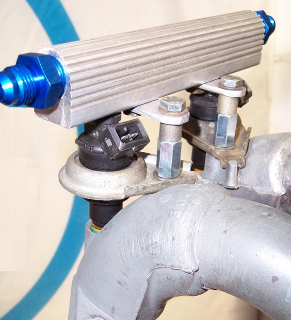

I've been working on upgrading the components of my custom fuel injection setup. One of the upgrades I've had in the works for awhile was adapting the newest Bosch injectors. These have an improved spray pattern, are high-impedance, and are available in a variety of spray volumes. And they're TINY!
But like any of this stuff, you can't just bolt them on. I decided to make some fancy adapters that would look mostly original. This was one of my first projects to help teach myself Fusion360 CAD modeling.
Got a couple 3D prints from some of our members, which illustrated a few issues with my design. A few changes were made and I pulled the trigger on an initial run of 20 pieces (5 engines).
Just received these parts back from anodizing and did a final test fit. Everything looks perfect. So it's time to install this and my upgraded AAR on my 1.7 Turbo and see how these new additions help things.

Will the engine go back in with those rails? With straight hoses the existing rails hit the engine shelf. These will not bend out of the way.

Jeff Bowlsby   Nice to have an option. I see this new bracket is...   Apr 15 2018, 03:33 PM

Dave_Darling   Is there any reasonable way to have the electrical...   Apr 15 2018, 09:37 PM
barefoot   Nicely done, for your future runs, please add some...   Apr 16 2018, 05:07 AM
brownaar   Very nice. My only concern is have you added anoth...   Apr 16 2018, 08:03 AM
McMark   Will the upgraded AAR be available as a group buy ...   Apr 16 2018, 09:30 AM
Jeff Bowlsby   Nothing, I suppose. I'm not sure why they wou...   Apr 16 2018, 10:25 AM
McMark   Nothing, I suppose. I'm not sure why they wo...   Apr 16 2018, 11:43 AM
Jeff Bowlsby   The chart indicates a 300 kPA test pressure for al...   Apr 16 2018, 12:18 PM
barefoot   I'd love to hear more about what you mean. ...   Apr 16 2018, 01:55 PM
McMark   I'd love to hear more about what you mean. ...   Apr 16 2018, 02:20 PM
McMark   I think I need to order some 90-degree elbows...   Apr 16 2018, 12:04 PM
Dave_Darling   I think I need to order some 90-degree elbows... ...   Apr 16 2018, 12:23 PM
McMark   I think I need to order some 90-degree elbows...Or...   Apr 16 2018, 02:19 PM
Dave_Darling   The problem there is that the 1.7 an 2.0 runners h...   Apr 16 2018, 07:20 PM

jcd914   Why not build a fuel rail with proper openings for...   Apr 19 2018, 09:08 PM
rdauenhauer   :idea:   Apr 19 2018, 09:40 PM
John Jentz   :idea: Will the engine go back in with those rai...   Apr 24 2018, 08:04 AM
jcd914   Yes I was thinking of something like that. But I ...   Apr 19 2018, 09:48 PM
edwin   Have you changed the lower orings on the injectors...   Apr 23 2018, 08:17 AM
McMark   Why not build a fuel rail with proper openings for...   Apr 23 2018, 12:04 PM
Mikey914   I always remove my fuel rails (at least now), as i...   Apr 24 2018, 09:19 AM
McMark   :agree: Mike's got it. Pulling the injectors ...   Apr 24 2018, 09:37 AM
