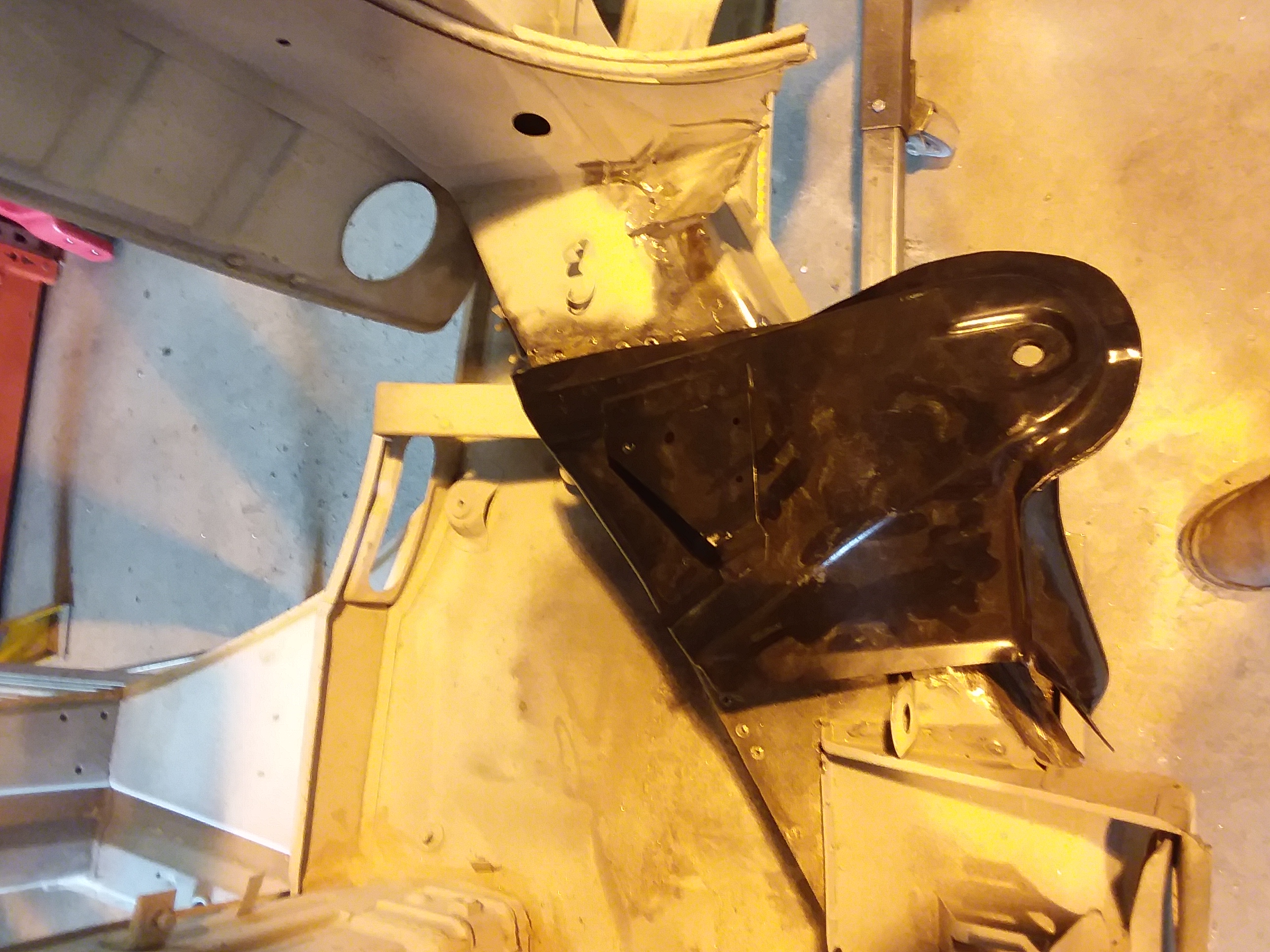

Taylor.914   Some good progress was made this weekend on firewa...   Aug 6 2018, 09:25 PM
Taylor.914   RE: Taylors new project thanks to Wes   Aug 6 2018, 09:26 PM
Taylor.914   RE: Taylors new project thanks to Wes   Aug 6 2018, 09:27 PM

Mikey914   just ordered up the passenger side engine tray sec...   Aug 8 2018, 04:52 PM
wes   Amazing work, turned out the car had more rust tha...   Aug 8 2018, 05:07 PM
