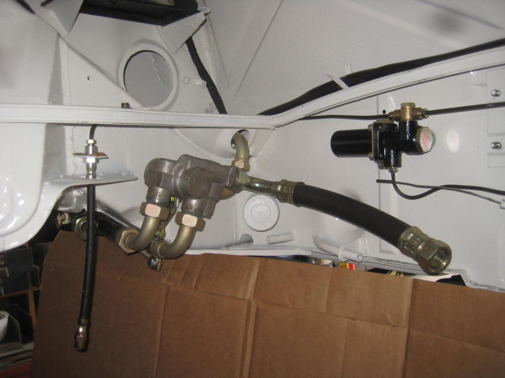

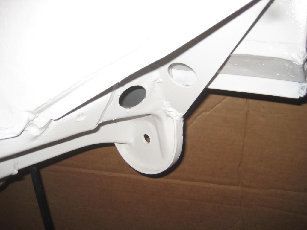

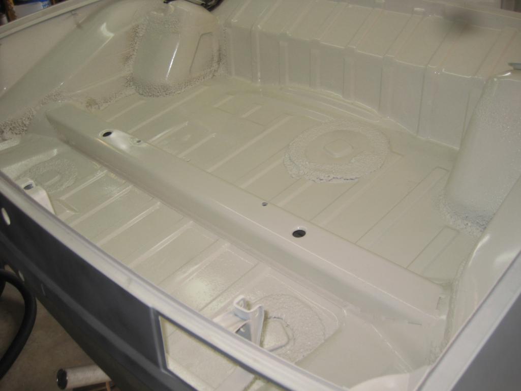

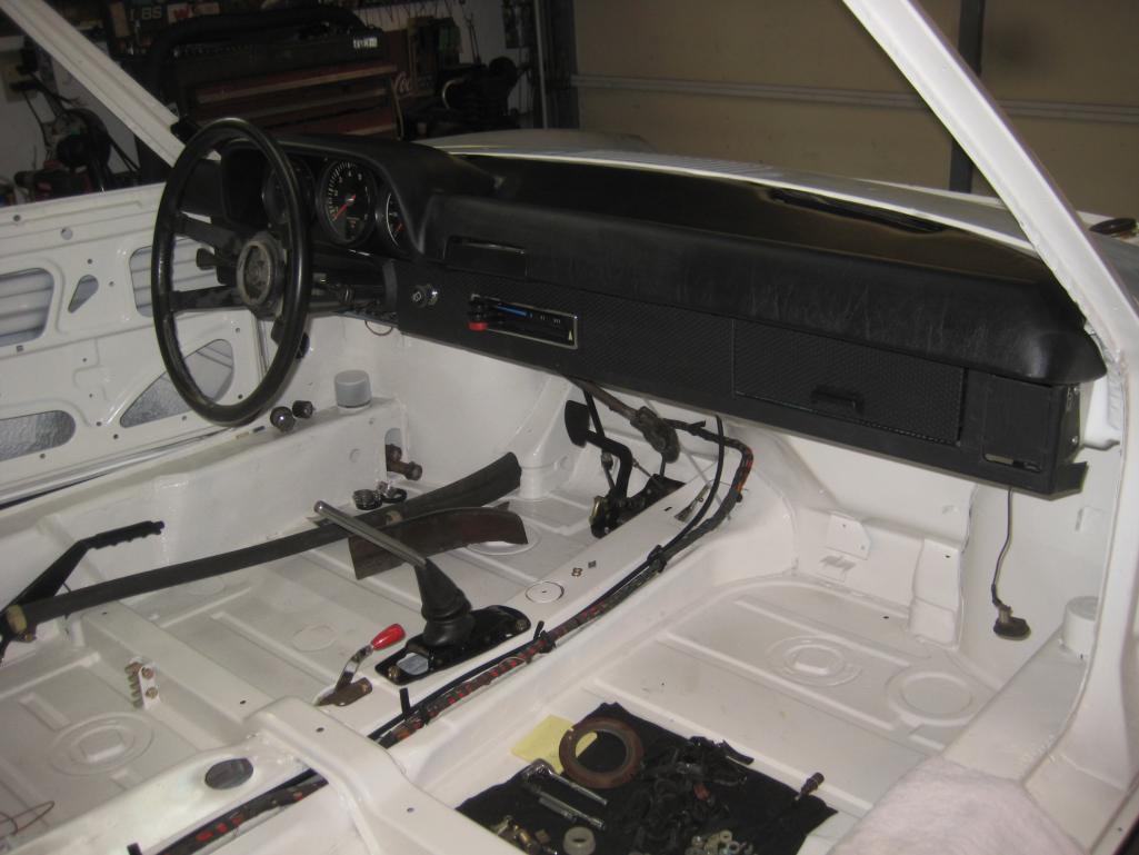

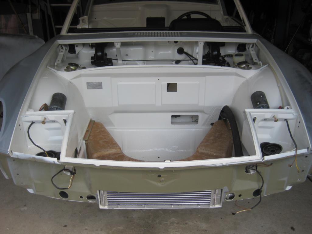

Some new pics since last report eight (!) months ago.
'6' harness in, dash and instruments in and wired, 6 column in, brakes all plumbed,
fuel lines in tunnel, speedo drive in tunnel, pedal cluster rebuilt and in, shifter freshened,modified and in, all suspension rebuilt and waiting ( install before or
after paint ?) thermostat and front cooler plumbed , etc.etc.etc.
I'm going to go with a '68 2.0 alum. engine for starters. It's been rebuilt and never started so this is a way to establish soundness for eventual sale.
