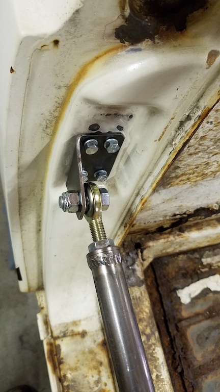

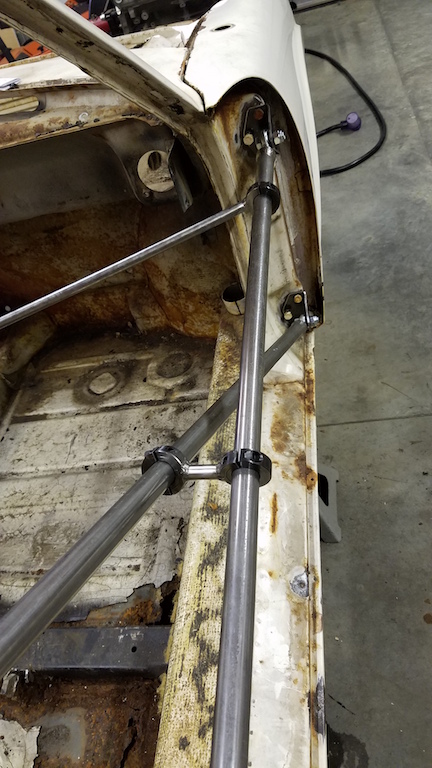

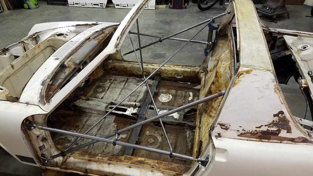

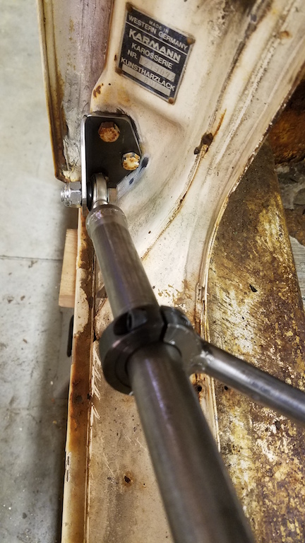

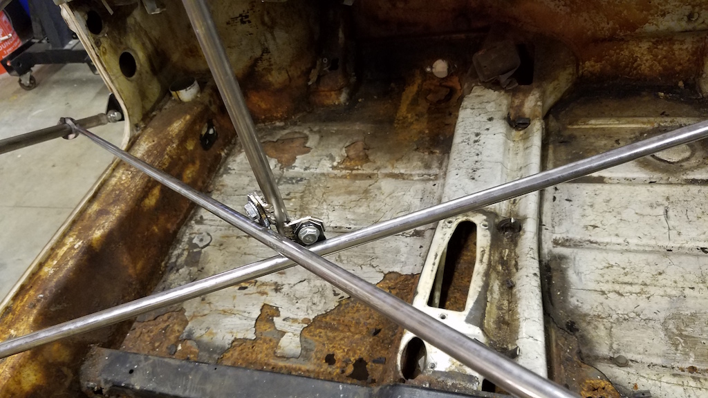

Well I have been busy and hope to stay busy. With as much metal work as this car needs, a rotisserie is in needed. So I'm going to build one based off the blue sky motorsports plan. In the process of stripping the car I realized there is a lot of rust to the passenger side frame rail along with a nice dent (pics to come later). Thus I need a good way to keep the car straight while repairs are made so I came up with this.
The idea is that triangles are stiff and tying each support to one another should do a good job at preventing any sagging or deformation. This is my first go at a rotisserie restoration so those who are experienced, please feel free to chime in on ways you have prevented the dreaded sagging frame that I've read about. When the doors were removed the gaps looked great. Lets hope they stay that way.

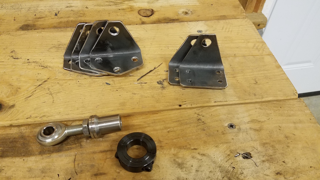

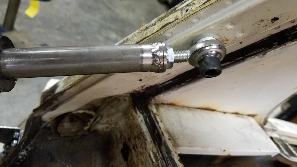

Here's some more detailed pics
The entire system is modular and bolts in except for the vertical tube in the center that is tack welded to the underside of the windshield frame.
All the small diameter tubing is clamped to the larger tubing via shaft collar. Which should allow adjustments to be made to the length of the larger tubing members if the chassis where to flex.

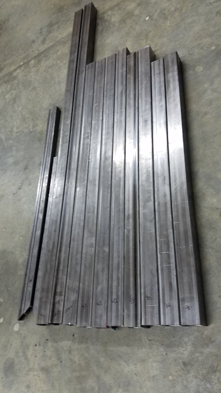

Lastly, heres a start on the rotisserie.
