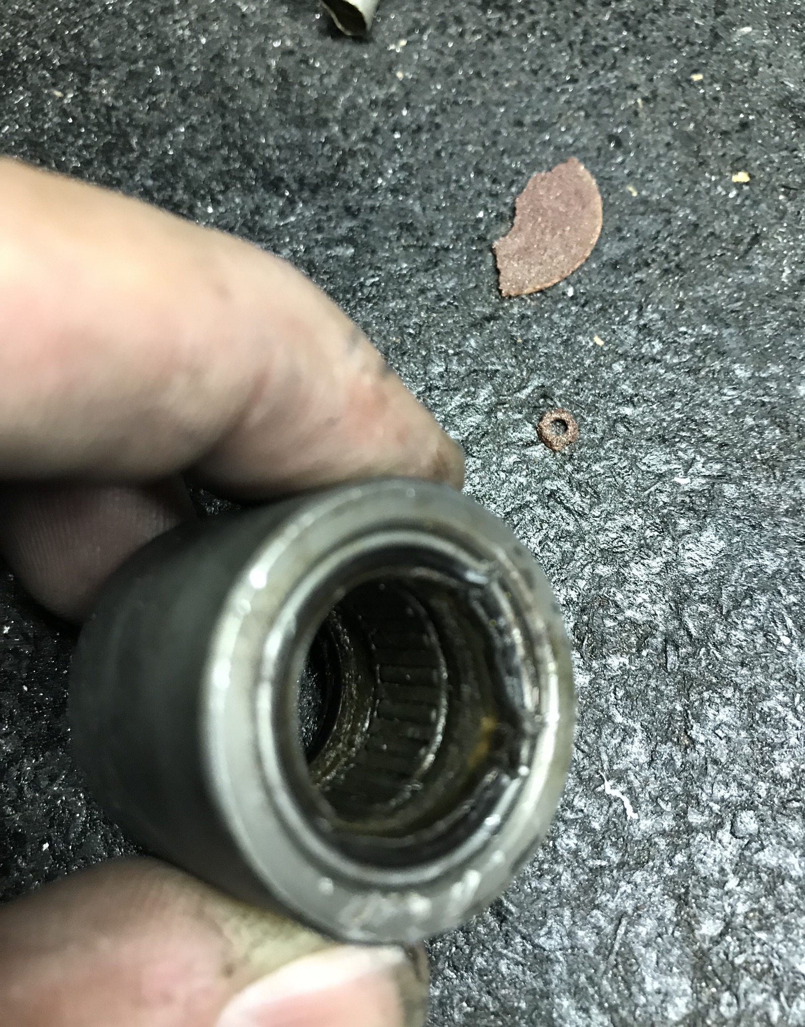

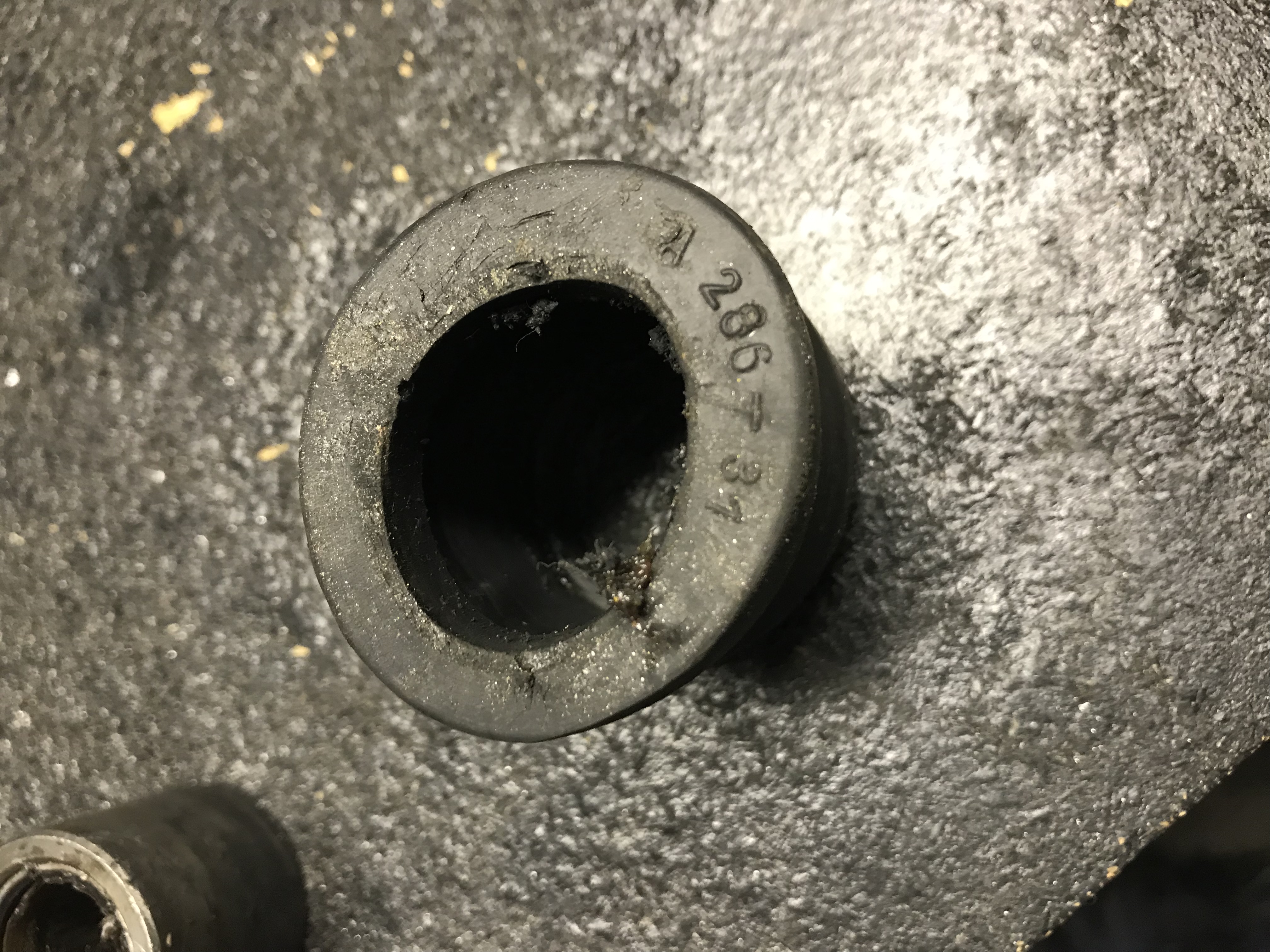

Good thing I ordered a new bearing and bushing...these are ugly...

naro914   Good thing I ordered a new bearing and bushing...t...   May 10 2018, 06:38 PM
cuddy_k   The condition of that bearing may be related to wh...   May 10 2018, 09:34 PM
naro914   The condition of that bearing may be related to w...   May 11 2018, 05:13 AM
