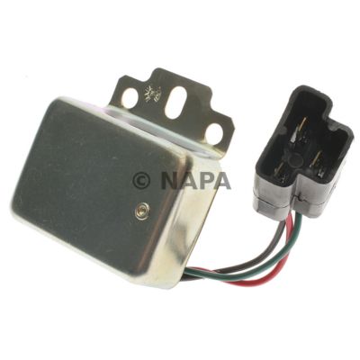

Replace the VR with another I had that previously tested good. still no charging. checked the plug on the relay plate again. looks good.

Aaaaand a new voltage regulator...
...didn't resolve it. Same problem. Wish I understood alternators better so I could understand the problem, but oh well. And I get to replace the alternator pigtail with a new one.
At least now I have a spare VR. Odd one too, from Echlin, remote mounts.
