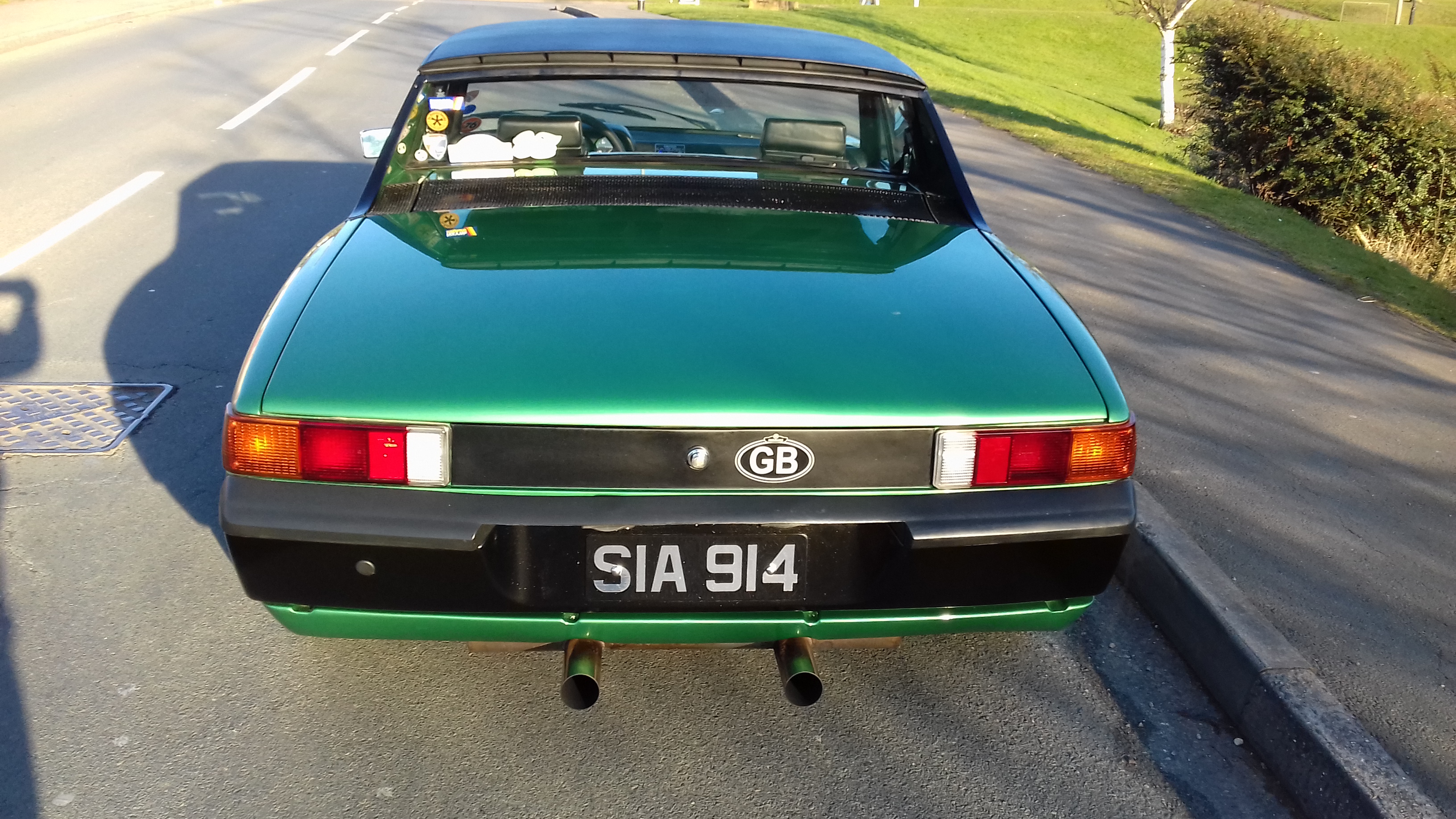

green ernie
post May 25 2018, 10:10 AM
Posts: 52
Joined: 25-January 15
From: United Kingdom
Member No.: 18,354
Region Association: England
QUOTE(Dougster @ May 23 2018, 06:48 AM) *
With a 2.0 /4 ... Is there any options for getting the look (without sacrificing performance) of the dual exhaust like you see on the factory /6 and in particular the factory GT cars? I thought Dansk had an offering for this, but can not locate it now. Basically I'm after the look of separated tips coming straight out, but not really close together (like boxster, etc). Don't need chrome tips.
I'm always confused why you see the 1.7s with dual tip ansa mufflers (I don't want duals on both side for my 2.0) , but the 2.0L cars always get a single tip. Also, I see there are some "GT" style mufflers for /6 cars... but then there are size differences amongst the /6s, could none of them be used on a 2056cc type IV based on a stock 2L ? Any other options?
I also had one made by Turbo Thomas in stainless steel in the UK last year. Looks great, very loud and sets off car alarms. Great quality too. Cost about $900.Attached Image

green ernie   With a 2.0 /4 ... Is there any options for gettin...   May 25 2018, 10:10 AM
Dion   I also had one made by Turbo Thomas in stainless s...   May 25 2018, 04:03 PM
