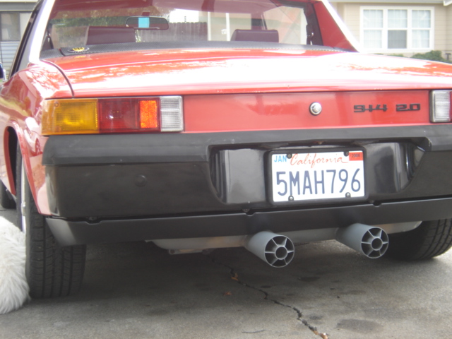

With a 2.0 /4 ... Is there any options for getting the look (without sacrificing performance) of the dual exhaust like you see on the factory /6 and in particular the factory GT cars? I thought Dansk had an offering for this, but can not locate it now. Basically I'm after the look of separated tips coming straight out, but not really close together (like boxster, etc). Don't need chrome tips.
I'm always confused why you see the 1.7s with dual tip ansa mufflers (I don't want duals on both side for my 2.0) , but the 2.0L cars always get a single tip. Also, I see there are some "GT" style mufflers for /6 cars... but then there are size differences amongst the /6s, could none of them be used on a 2056cc type IV based on a stock 2L ? Any other options?
