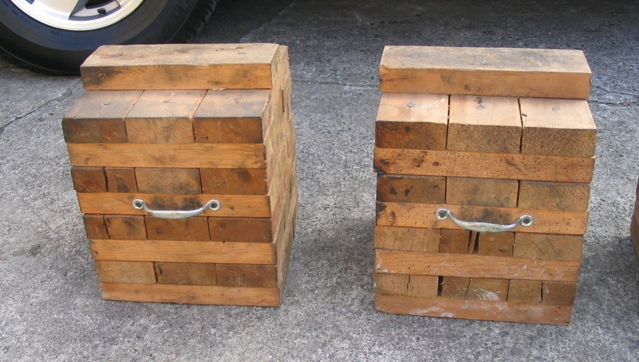

The Cabinetmaker   I use two pieces of 2X2 with a groove on one side ...   May 18 2018, 06:20 AM
marksteinhilber   I use two pieces of 2X2 with a groove on one side...   May 18 2018, 03:26 PM
