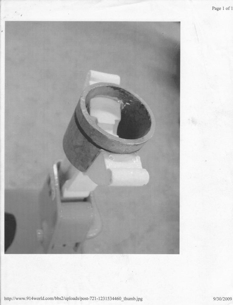

Some one cut a small section of pipe so the donut fit the ID. He notched the pipe to fit over the top of the jack stand.Attached Image

Geezer914   Some one cut a small section of pipe so the donut ...   May 26 2018, 06:04 PM
marksteinhilber   Some one cut a small section of pipe so the donut...   Jan 8 2019, 11:34 AM
