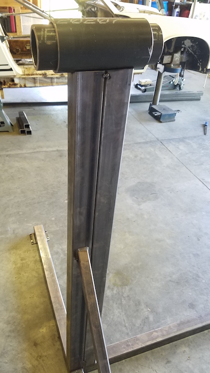

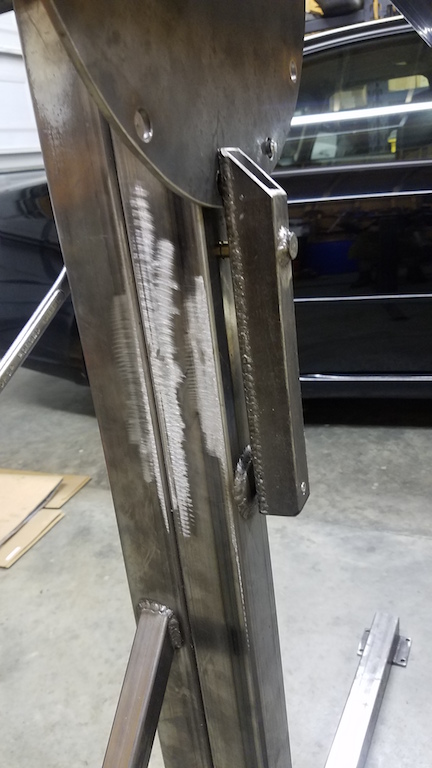

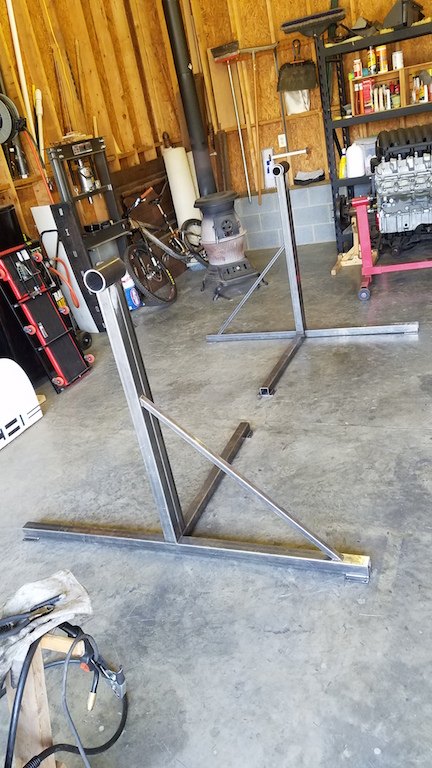

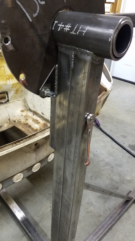

So the rotisserie is starting to take shape. Trying to hold back and go by the KISS method since this is just a means to an end..
I went decided to veer away from the blue sky motorsports plans slightly with a different locking mechanism. Theres a plate with holes and spring pin that will catch the holes a set locations and a nut/bolt clamp that locks on that plate to really keep things from moving when needed.
