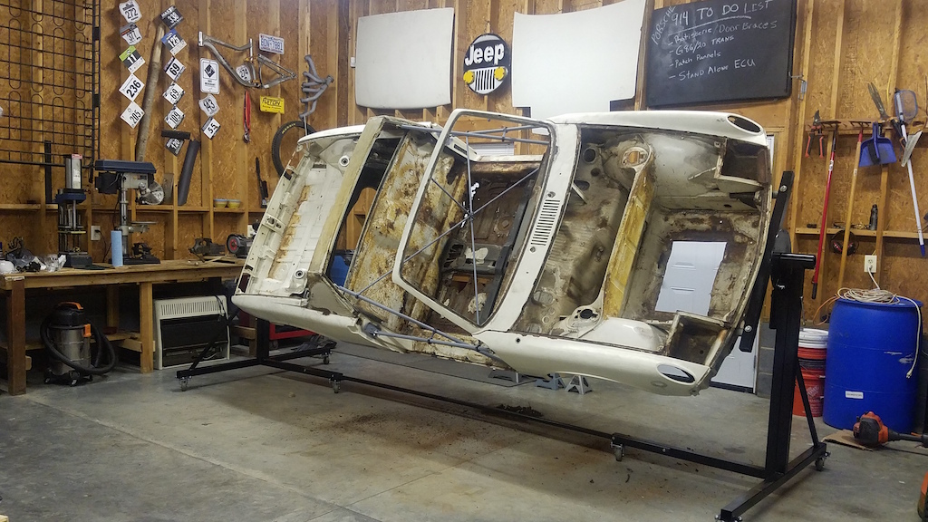

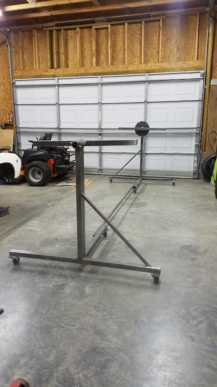

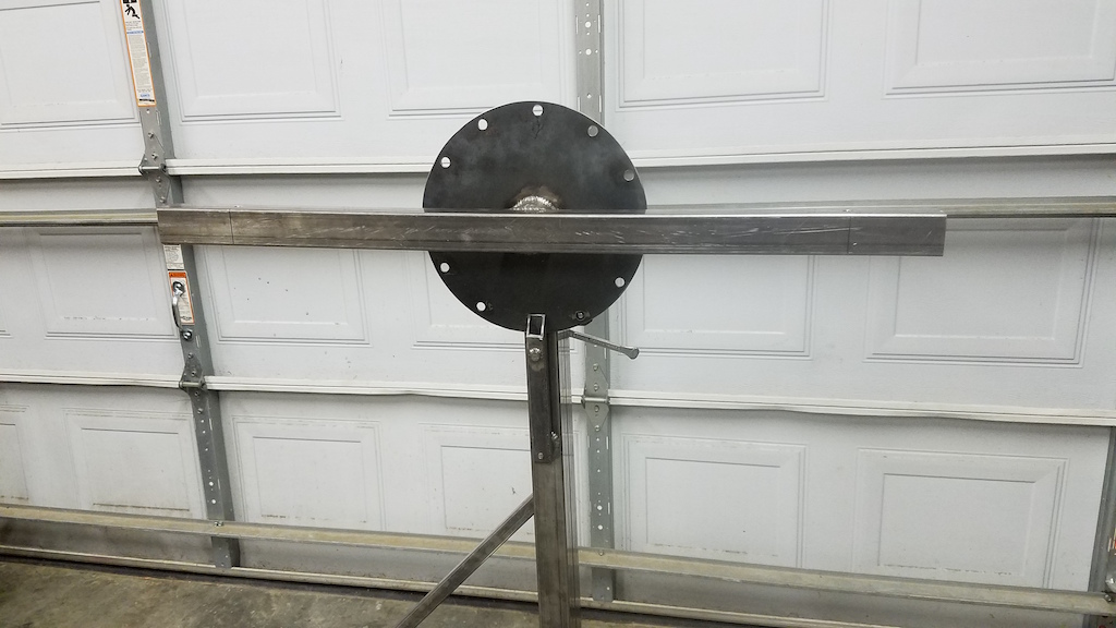

The rotisserie is complete and the car is mounted. Here is the finished rotisserie. I wish I made a beefier tie bar between the front and rear supports. That may be a wise investment.
![]() Heres a overview of the locking end. ![]() And here she is mounted up. We have had ridiculously humid weather recently, so I painted all the bare steel on the door supports and the rotisserie. ![]() |
