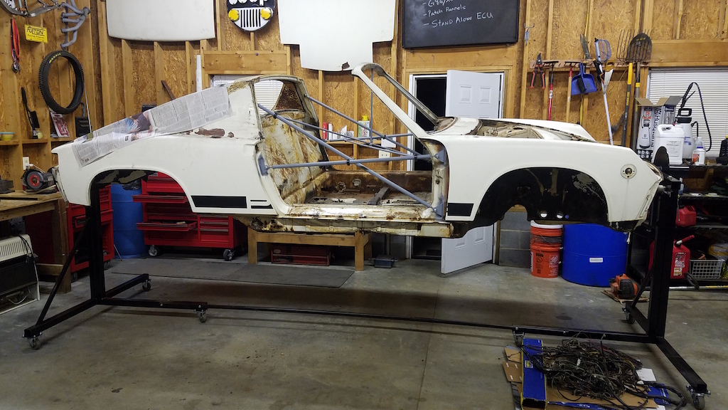

At this point the car is stripped and ready to be mounted on a rotisserie. Lots of bracing prior to mounting on the rotisserie of course.

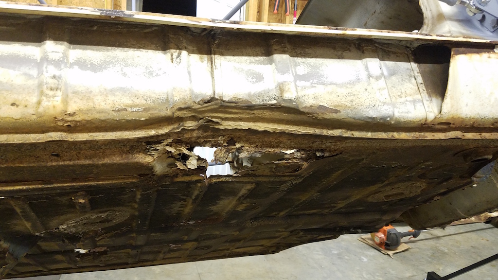

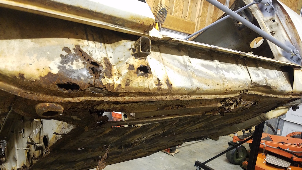

Here's some good pics of the worst section on the car. The passenger long is not only rusted through near the hell hole, it's also crushed from who knows what.
So at this point I'm wondering if it would be easier in the long run to get the entire thing blasted or dive in repairing the major problem areas?
