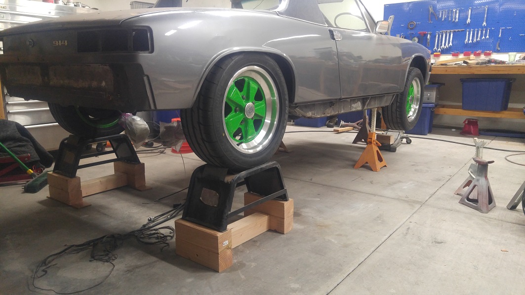

I found my floor has a slope side to side at about 3/8 of an inch. If I use some left over 3/8 bamboo flooring on the drivers side it gets me level side to side.
For the back I used a couple 4x4 screwed together and then screwed the ramp stands to it in the back. I dont have any more ramp stands for the front, so I used jack stands at the forward lift points and then a single jack stand at the front trunk floor.
Its mostly level, I need to drop the drivers side rear coilover a 1/4 of an inch or so. I will do that tomorrow.
What do you all think?

porschetub   I post every so often in the what did you do to y...   Jun 12 2018, 11:54 PM

daytona   Nice looking car and all the work looks good. But ...   Jun 13 2018, 06:02 AM

mepstein   I’m a chicken shit. I would never work under a c...   Jun 13 2018, 06:28 AM
914forme   Travis I would screw a bunch of 2z4s in a stack to...   Jun 13 2018, 10:08 AM
Travis Neff   I'll take a look at adding a 4x4 as a 2nd i-be...   Jun 13 2018, 10:50 AM

Travis Neff   Thanks for all the input so far, I appreciate the ...   Jun 13 2018, 01:31 PM
Mueller   Thanks for all the input so far, I appreciate the...   Jun 13 2018, 04:10 PM

mepstein   I throw extra wheels with tires under the car. I a...   Jun 13 2018, 03:35 PM
Travis Neff   I added a 4th jack stand underneath the tunnel abo...   Jun 13 2018, 03:48 PM
mb911   I need to post the picture of my no fail jack stan...   Jun 13 2018, 03:55 PM
Travis Neff   I need to post the picture of my no fail jack sta...   Jun 13 2018, 05:29 PM
mepstein   I need to post the picture of my no fail jack sta...   Jun 13 2018, 06:24 PM

djb   Really great thread! Consider using a water l...   Jun 13 2018, 10:10 PM
Travis Neff   Really great thread! Consider using a water ...   Jun 13 2018, 10:40 PM

mb911   Here is the jack stand that is none fail..   Jun 14 2018, 09:42 AM
