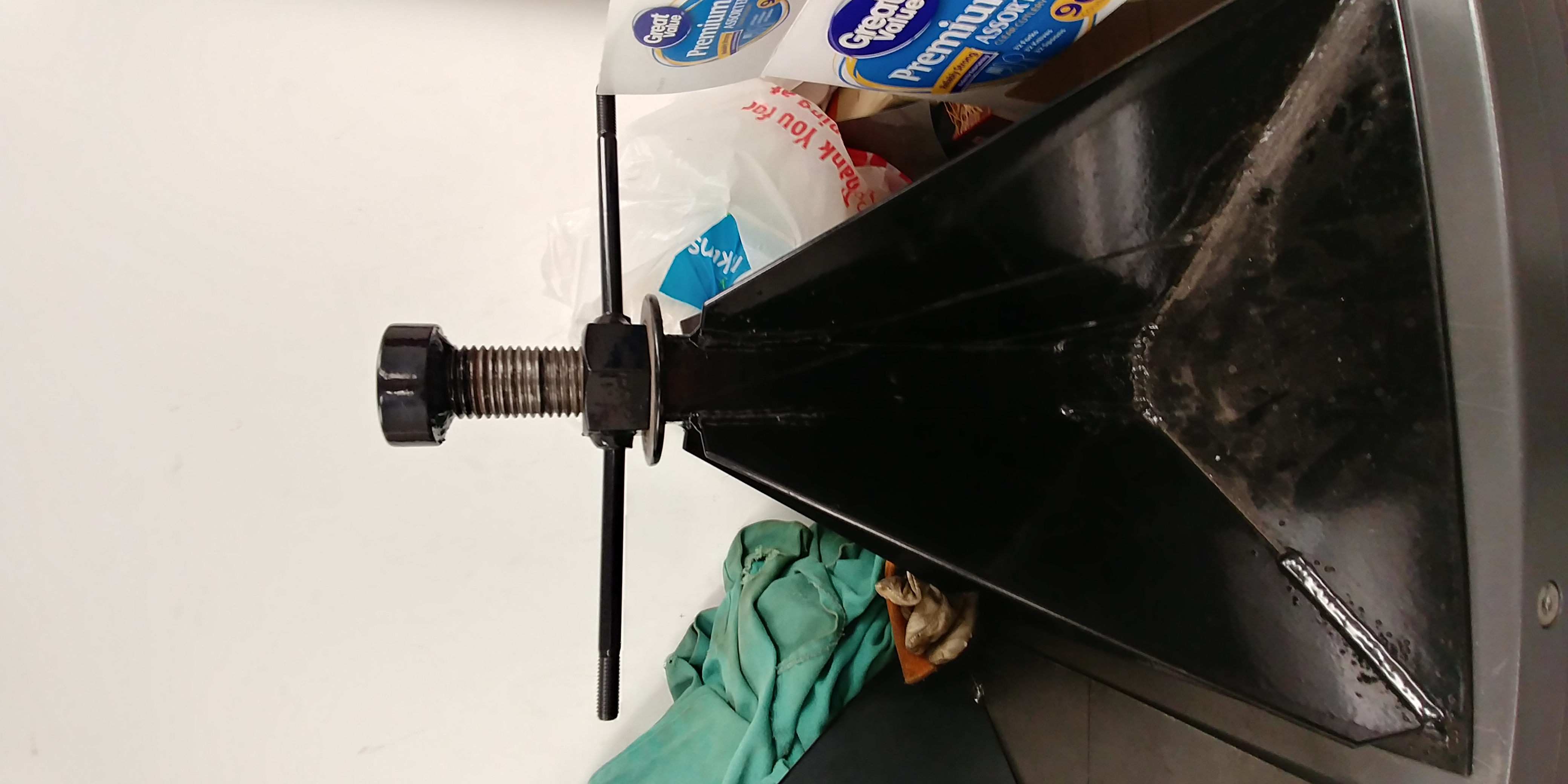

Here is the jack stand that is none fail..

mb911   I need to post the picture of my no fail jack stan...   Jun 13 2018, 03:55 PM
Travis Neff   I need to post the picture of my no fail jack sta...   Jun 13 2018, 05:29 PM
mepstein   I need to post the picture of my no fail jack sta...   Jun 13 2018, 06:24 PM

mb911   Here is the jack stand that is none fail..   Jun 14 2018, 09:42 AM
