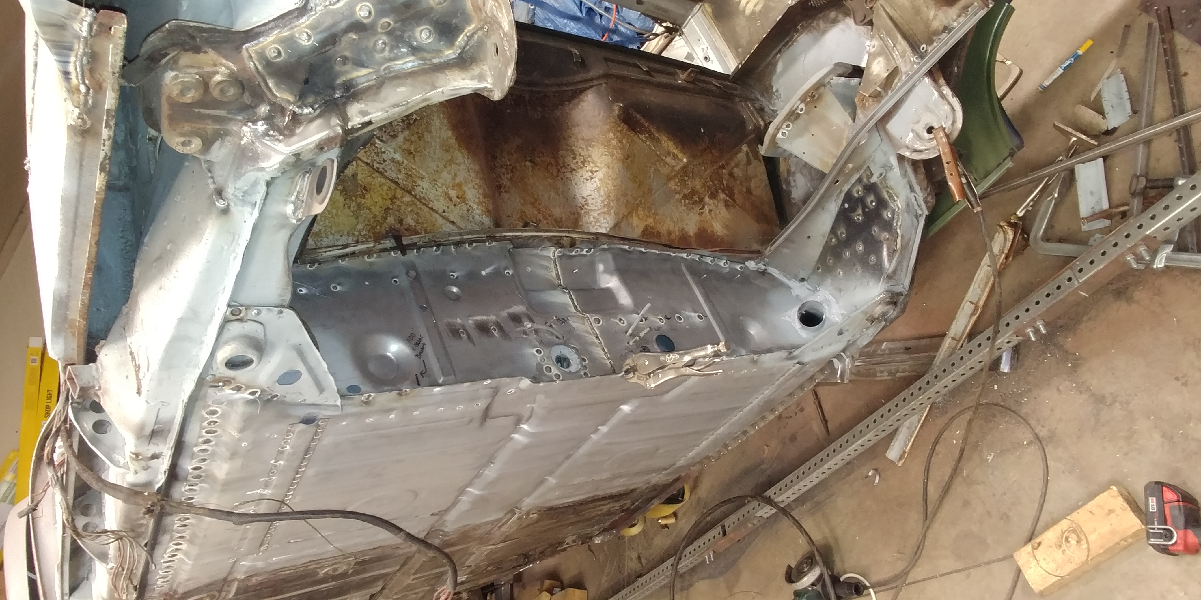

When removing my 4 mounts I made 14 gauge over lay reinforcements.. I will see if I can dig up a picture.. oops just found one. Attached Image

Travis Neff   I started grinding the paint away where I needed t...   Jun 14 2018, 10:50 PM
Travis Neff   All burned in. Not the prettiest, but it will work...   Jun 14 2018, 10:52 PM

Larmo63   I see you took the /4 mounts out, I left mine in. ...   Jun 15 2018, 05:43 PM

mb911   When removing my 4 mounts I made 14 gauge over lay...   Jun 16 2018, 06:22 AM
Travis Neff   I thought about leaving the mounts in when I had t...   Jun 16 2018, 11:11 AM
mb911   I thought about leaving the mounts in when I had ...   Jun 16 2018, 11:20 AM
Travis Neff   Beautiful! Obviously not done with a metal glu...   Jun 16 2018, 11:23 AM
mb911   Beautiful! Obviously not done with a metal gl...   Jun 16 2018, 12:47 PM

Travis Neff   Patched a small part of long and put a backer in p...   Jun 21 2018, 11:18 PM
Travis Neff   Forgot a pic of the good looking side   Jun 21 2018, 11:27 PM
Travis Neff   I put in the backing panel against the inside long...   Jun 23 2018, 09:57 PM

Travis Neff   Patch is in. Had to grind down some the welds to ...   Jun 24 2018, 02:31 PM
Travis Neff   Moving on.. This cut exercised my pelvic floor pr...   Jun 24 2018, 04:15 PM
Travis Neff   Looked a little further and the bump for the -4 mo...   Jun 24 2018, 07:34 PM
