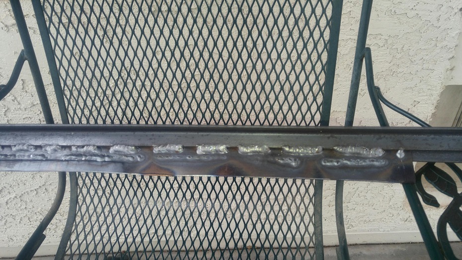

I thought about leaving the mounts in when I had them halfway out. I was getting frustrated that I might not be able to get them out without a huge leftover mess!
I like the overlays and am thinking about something similar. Ollie's 914-6 blog has something like that as well. I will decide once I get the longs all fixed up.
I took Ben's critique on my mounts and while I didn't really like to hear it, I needed to. And I am thankful to get the feedback. So I went out and did some practicing and fooling around with the controls. I am going to try to practice a little bit each day before I start doing any more weld in work. Also on plug & butt welds. It's easy to rush to get something done vs. trying the best you can and slow down a bit.

QUOTE(Travis Neff @ Jun 16 2018, 09:11 AM) *
Looks very good.. Big improvement. Remember I have done it professionally for 25 years plus. It takes a while to be able to weld like this.Attached Image
